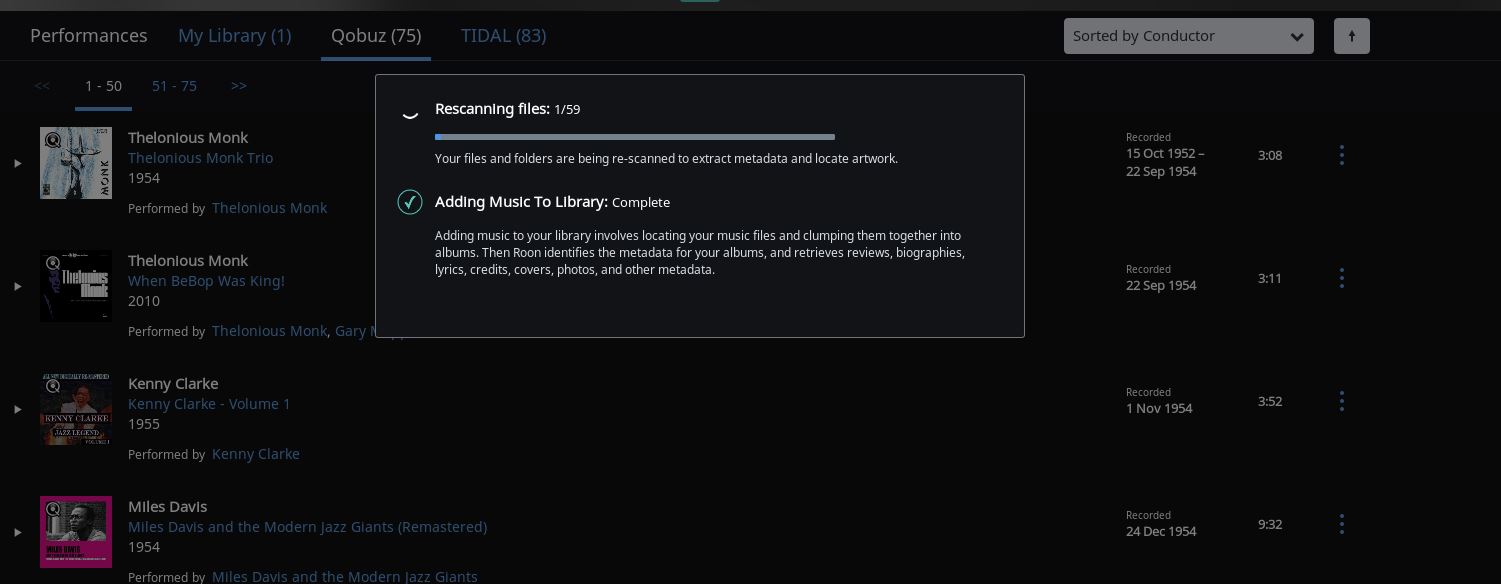

Can you please share a screenshot of your Activity Spinner page? It should look something like this:
I have also gone ahead and enabled diagnostics mode for your account and what this action will do is next time your Core is active, a set of logs will automatically be generated and uploaded to our servers for analysis.
Thanks,
Noris
Here it is - thanks Noris
Hello @dim_fink,
Thanks for sharing that screenshot. I am unfortunately not seeing any diagnostics reports from your Core reach our servers. Can I please ask you to manually send me the log files from your Core using these instructions? The best way to get them over to me would be by using a shared Dropbox or Google Drive link but if you don’t have either service just let me know and I can provide an alternate upload method.
