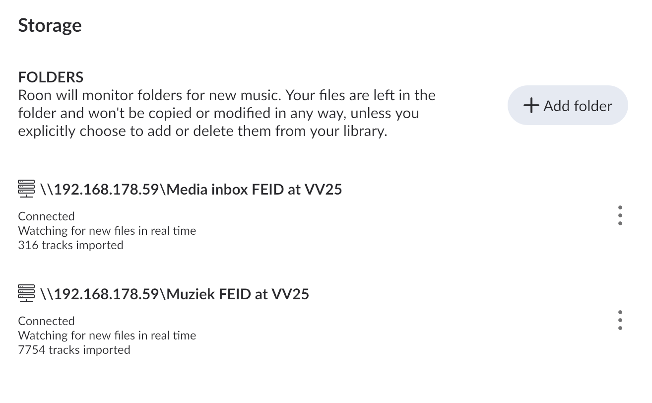

Rock is connected to 2 folders on a NAS. One indicates Connected/Watching for new files in real time/316 tracks imported and the other indicates Connected/Watching for new files in real time/7754 tracks imported. Hence, I cannot make sense of the number of 17 files.
