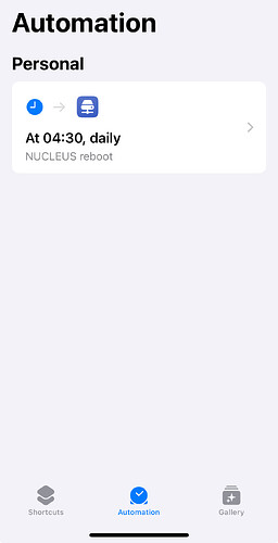

In the iOS app Shortcuts create a new Shortcut named “NUCLEUS reboot” containing:
Get Wi-Fi network’s Network Name
If Network Details is HomeWifiName
Get contents of //nucleus.local/1/reboot
End if
In the iOS app Shortcuts create a new Automation containing:
At 04:30, daily, immediately run “NUCLEUS reboot”
This reboot command only runs when my iPhone is connected to my home Wi-Fi network.
Of course you can choose your own time and dates to run the automation. Or use the shortcut manually.
For security reasons, the first time you run the automation iOS will ask to give permission to execute the “Get contents of //nucleus.local/1/reboot” command. I choose here “Always”, so the automation runs without user interaction while the iPhone screen is locked.
Since my Roon backups are scheduled to run at 02:00 I think it is safe to reboot the nucleus at 04:30, when I am most likely sleeping, and Roon is not busy with a backup.
HomeWifiName is a dummy name and to be replaced by your own home wifi network name.
nucleus.local is to be replaced by your own Rock hostname or IP address.
Instead of /1/reboot you can also use /1/restartsoftware.

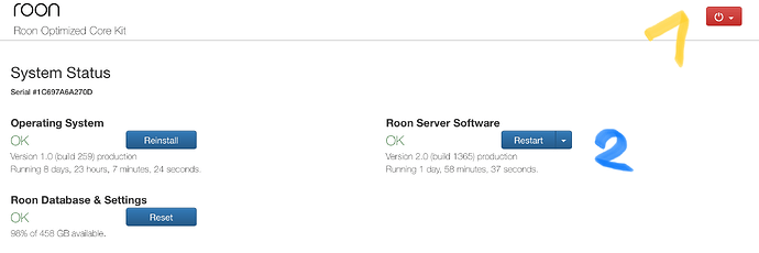

For me:
restartsoftware fixes problem (2)
Restart core is NOT necessary (1)
For ROCK, i am using the following command: (1)
