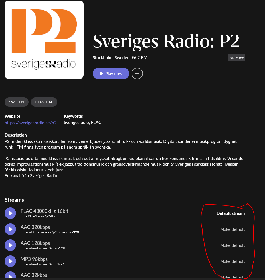

I like to listen to Sveriges Radio P2 with my choosen “Default stream” format: FLAC 48kHz 16bit. That worked fine for a long time.
Lately, however, I regularly get a different stream format than my “Default stream”. One time I receive an AAC 48kHz 2ch 320kbps stream (despite of the “Default stream” setting) and another time it is the FLAC 48kHz 16bit stream (the “Default stream”).
Is it possible to do something about this so that I always get the FLAC stream?

You should be able to make the stream you desire the default by clicking “make default” (assuming you see the one you want on the list and it does not get removed from your list of available streams):
@bearFNF, thanks for your reply.
I chose the FLAC format as the default stream a long time ago.
I can well imagine your reaction to my message. I did not translate the Roon terminology correctly from Dutch (I use the Dutch language setting in Roon) to English. Instead of “Default stream” I incorrectly used “Standard stream”. I have adjusted the original message accordingly.
