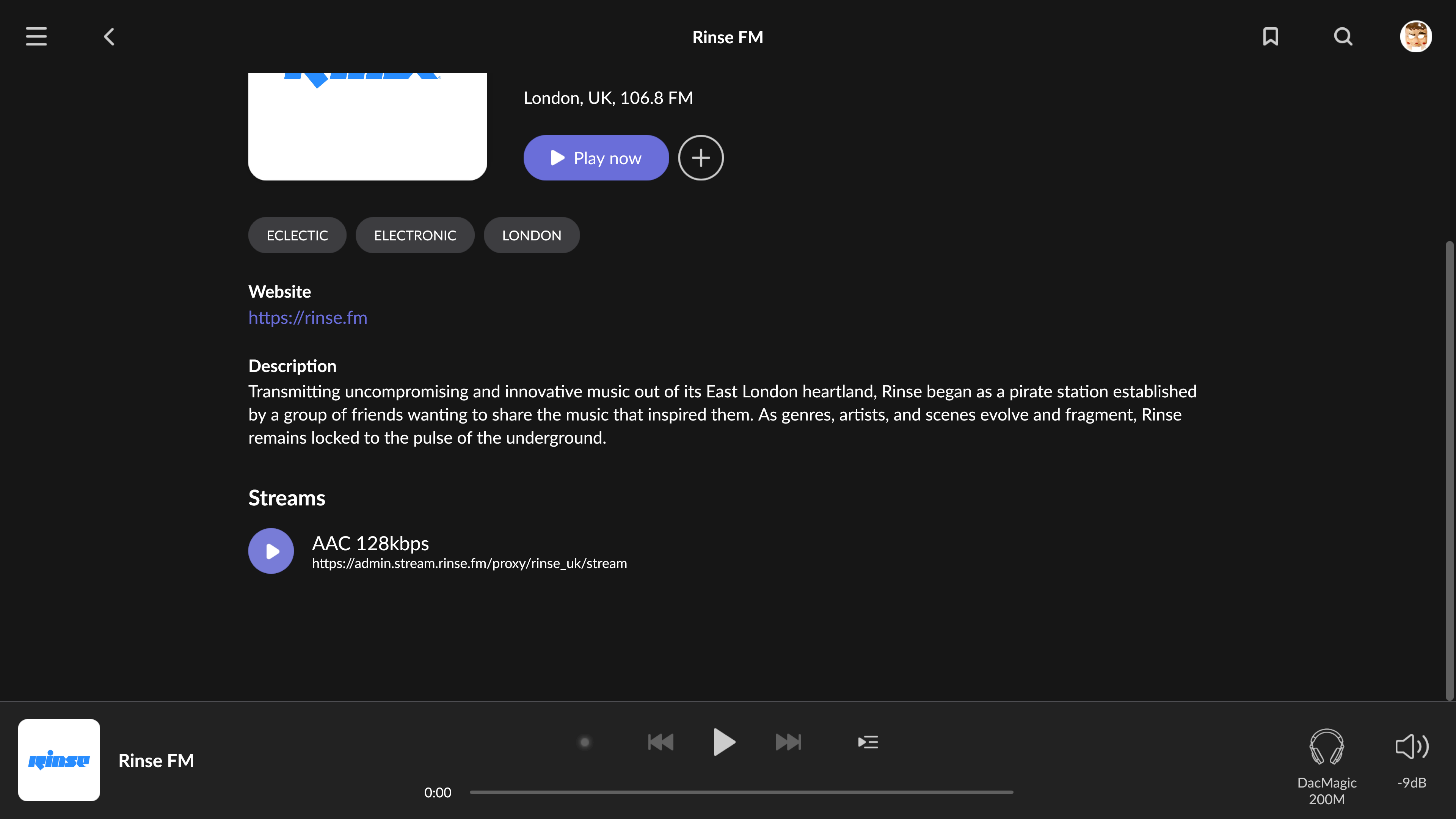

· Rinse FM / Kool FM are not working for me. Every other radio station I have tried works perfectly (Radio Paradise FLAC, BBC Radio 6 AAC, NTS 1 MP3 etc.). I have tried dozens of radio stations in different formats and the only one’s that don’t work are Rinse FM and Kool FM. When I click play on the Rinse AAC stream it does nothing. I have included a screenshot of the stream that does not work. I am in England, if that helps.

Thanks for the report. We’ve taken a look at logs and see a repeating failure wiht this station
The logs actually show the Roon/RAAT stack doing everything right: ICY connect succeeds and the Zone transitions all the way to the buffer. This reflects what you’re seeing in the UI within Roon, and explains why there’s no error listed. But the actual stream then returns no data.
The fact that other users can’t reproduce and a DNS flush temporarily restored playback is a real clue here. admin.stream.rinse.fm is behind a CDN/proxy layer, and you’re likely resolving to a bad edge node.
Try setting your router DNS service to Cloudflare (1.1.1.1) or another known, reliable resolver if you have the ISP presets.
If you’re using a PiHole, try disconnecting it from the network temporarily.
Another note: Rinse FM tends to deliver empty metadata even when the audio stream is correct, so you’ll likely continue to see empty artist/title/album fields in the playbar.

We’ve reproduced this issue internally. From what we can tell, this will only affect Windows machines, so if you’re eager to stream this station in the meantime within Roon, you can potentially temporarily migrate your server to another MacOS/Linux machine if you have one available.
