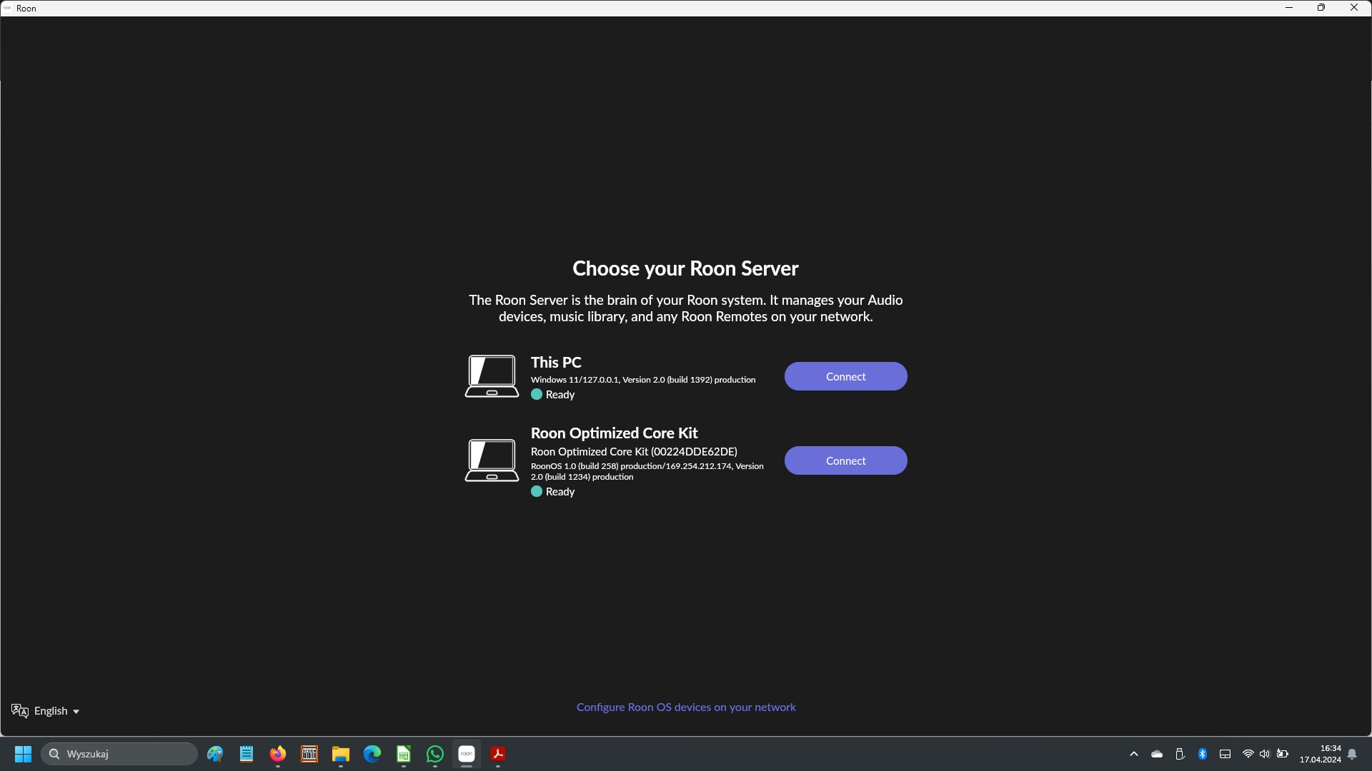

I need help, I configured ROCK as always, all looks good:
When I searching server to connect from another computer, it look good too:

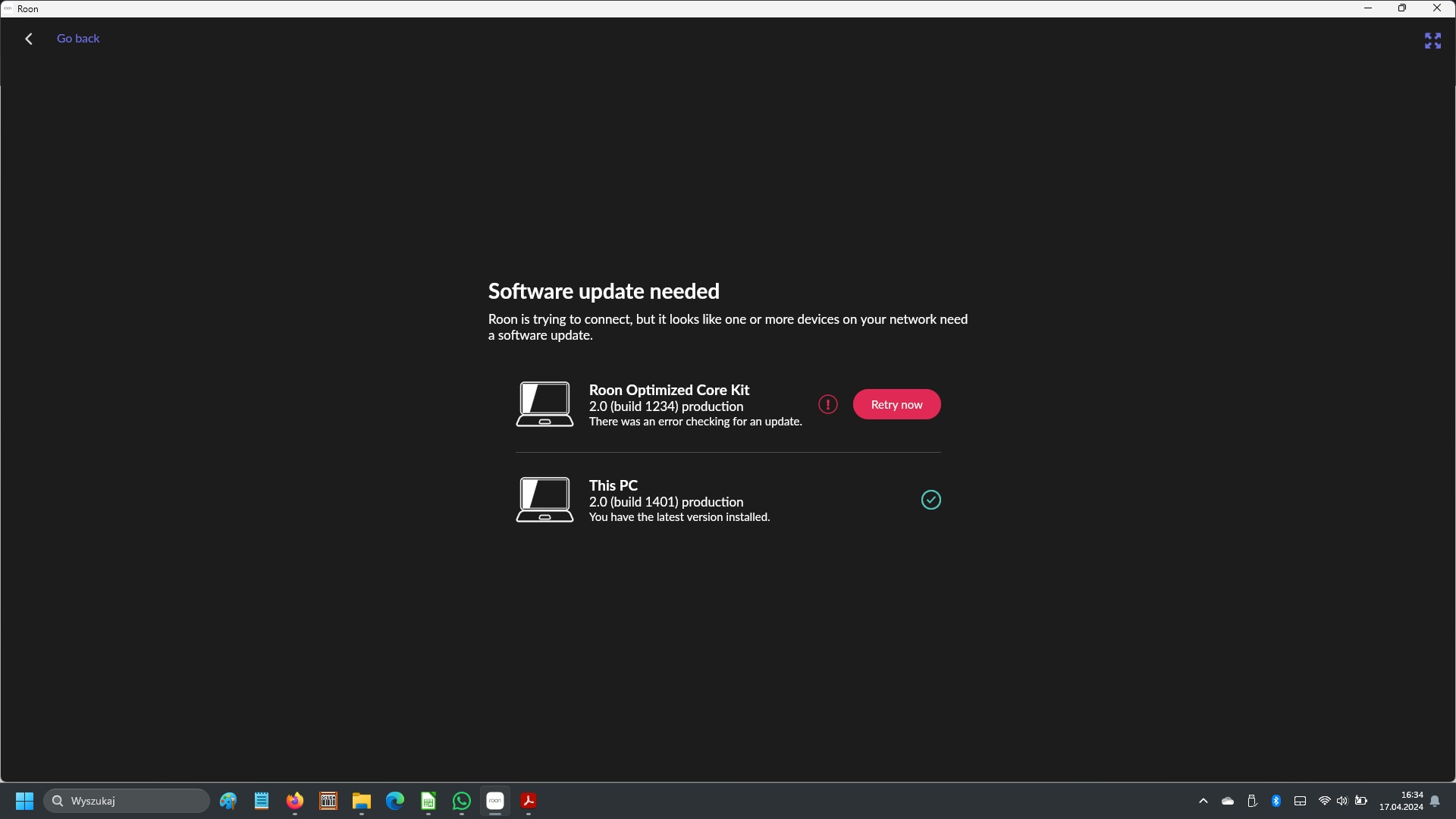

But when I tried to connect I see:
What can I do?

You are running a very old version of Roon server from March 2023, so it would seem that you’ve not updated ROCK for some time. Likewise, your remote (PC) isn’t using the current release either. These discrepancies may be the cause of the problem.
If you reinstall Roon OS on the web interface, this should update to the latest version of Roon server. As always, make sure you have a recent backup of your database.
You’ll also need to update your PC, and any mobile devices to the latest version.
However, you may prefer to wait for a reply from Roon support before proceeding.

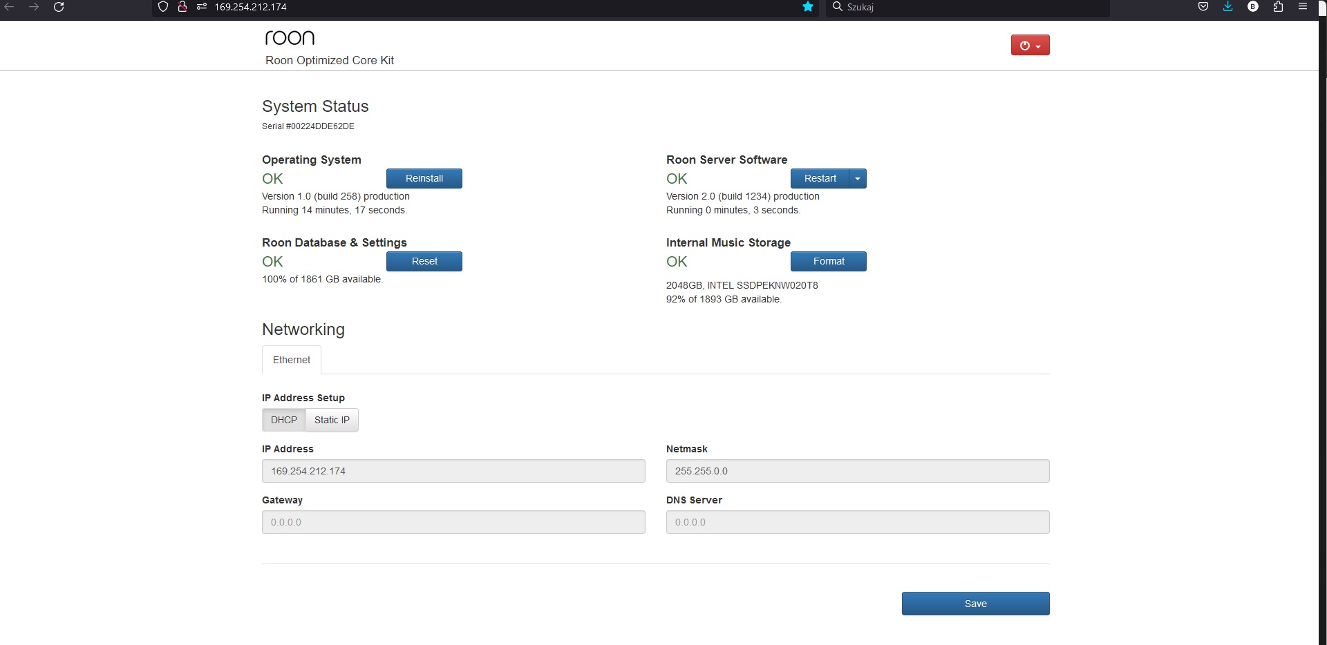

I tried but I have this message. Is it any possibility to install newest version offline?
@Grzegorz_Baranowski, the IP address and subnet is not what I’d expect for a private (home) network. Moreover, you don’t have a gateway or DNS set for ROCK. This would explain the error message.
Please confirm what hardware you are using for ROCK, how it is connected to your network, and how you assign its IP address.
This is very specific situation, I do it in my workhouse without internet. I am using laptop with internet via phone, I use the simplest 4-ports switch and I have to end this computer without transport to other places, it is huge and fanless and with heavy LPS. I tried to set network to set automatic DHCP (this is reason of strange IP) but there is difficult to make the laptop as router for internet. I used Windows tools, but it doesn’t work. Because of this I try to find off line solution to update roon server off line.
Since you are using an atypical network configuration, which isn’t supported by Roon, I am moving the thread to Tinkering where other community members may be able to assist you.
The IP address assigned to ROCK occurs when the device cannot obtain a real IP address from the router. In your case, you don’t have a router, or a DHCP server.
You may fare better building a server running Linux or a suitable Windows version that can provide mobile tethering, routing and networking for your workhouse network. Then run Roon Server instead of ROCK.
