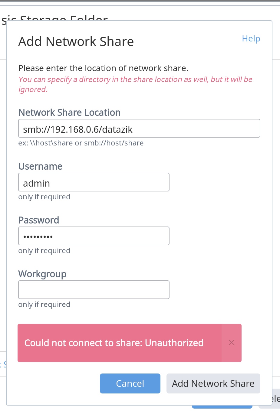

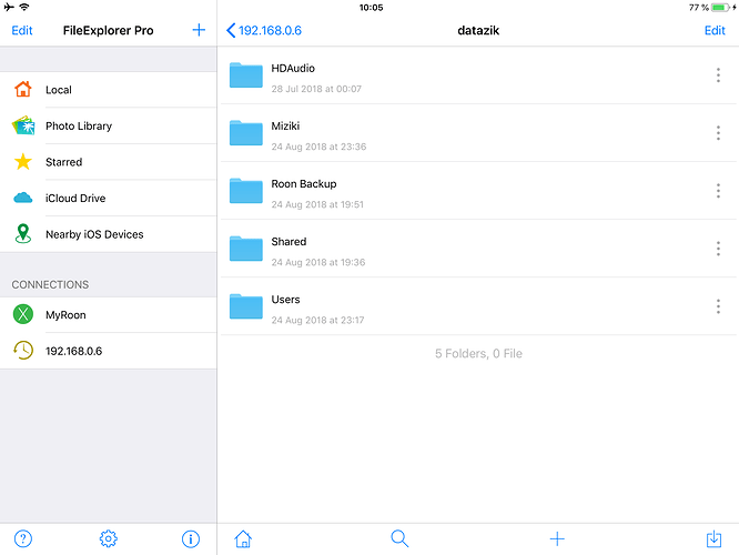

I’ve moved my core from MacBook Pro to NUC7i7BNH and can no longer access my music stored in a Time capsule. I can access it outside of Roon with the MacBook and with my iPad using FileExplorer Pro (see screenshots below).
I’ve read all support threads and more related to similar problem and tried the solutions suggested but it didn’t solve my problem. What am I doing wrong? Any help from you guys?

Hi Dylan. Thanks for following up. The TC is indeed tricky.
Yes I’ve rebooted the core multiple times, tried server name instead of IP and CIFS instead of SMB.
My network is quite simple. I use my ISP Modem/Router Sagemcom Fast3890. The TC, NUCi7 ROCK and one Usbridge are plugged directly to it by Ethernet. My other endpoints another Usbridge and DigiOne use 2 Airport Express ans a Sonos Bridge. The TC is in bridged mode and acts only as a file server (no WiFi network)

Yes I’ve tried both with no luck

Thanks for your patience here while the team has looked into this. Based on the information in the logs you provided, along with the tests that we’ve performed, it appears as though this is a general issue with the Time Capsule devices and Linux. We did some research and found this to be a rather common problem, not just with Roon.
I’m sorry I don’t have better news for you here. If you have an external drive it may be a good idea to try using that instead of the Time Capsule for media storage.
