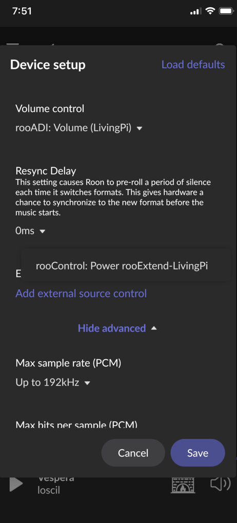

When I expand the Device setup on my iPhone for the RME ADI-FS Pro, it shows the information below:
Clicking on the “Add external source control” link does nothing. I have another streamer attached to the coax SPDIF input, but cannot figure out how to select it from this interface. Perhaps I am misunderstanding the usage.
This is where I would expect to be able to select different input sources to the RME.
The Roon source control is nothing more than a Power On/Off for the Roon Ready device controlled by Roon. If you have for example a Linn Streamer or KEF speakers with integrated streamer you can set them to Standby or On with this.
In the Source Control dialog you currently only see rooControl. If you have the Amazon Hub you can control the 5V USB voltage with it. Please take a look at the rooExtend-Box Manual. “On” will show a blue button, “Off or Standby” a red one. This is how it looks like in the Roon GUI (upper left corner):
Currently there is no source control for rooADI as the ADI-DACs don’t offer standby via remote control (what a shame :cold_sweat:).
My idea how this source control might be used with ADI DACs is as follows:
  • If you play back music from Roon via USB to the ADI DAC the button is blue and USB is selected as input source.
  • If you switch the button to red an other input of the ADI DAC will be automatically selected, for example Analog in for a turntable.
  • Which input will be selected in the case the button shows red you can configure in the rooADI setup dialog.
This can be used as follows:
  • Click the blue button during playback will stop Roon Playback, change button color to red and select the analog input.
  • If you click play the button color will change back to blue, USB input got selected and Roon starts streaming again.
  • If you click the red button it will change its color to blue and the USB input of the ADI DAC will be selected but playback from Roon did not start.
Hope this clarifies it a bit.
Best DrCWO
