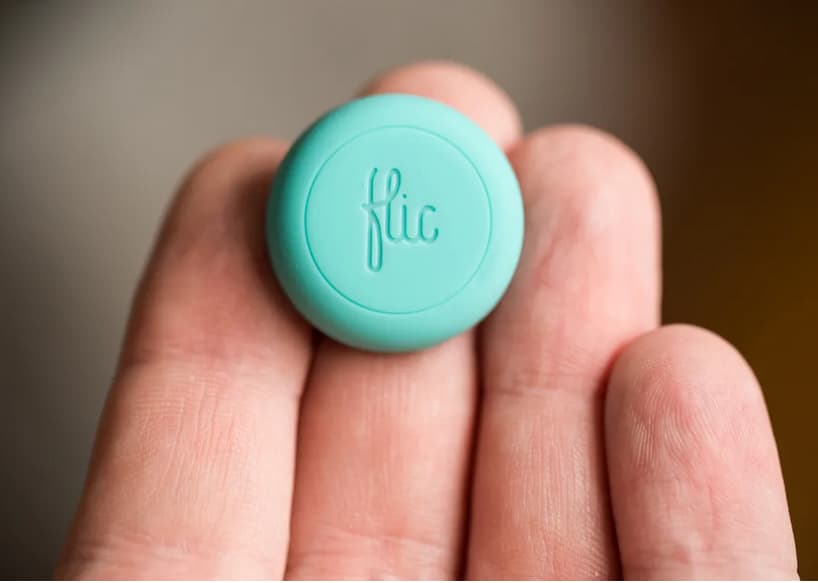

Do you think we might go the other way also, a minimal button like Flic to basically have in your hand/pocket?

Just got two of them: one for the kitchen table and one on the nightstand. I use them for quick playlist access, basic track controls (next) and turning off my systems. Nice little buggers.
How does that work, do you need the Flic Hub?
In my case they’re connected directly to a Mac mini M1 that I have running for various tasks (Roon, Plex, etc.). In the Flic app I have loaded a few Plugins that run shell scripts for various tasks (those related to Roon talk to RoonCommand).
