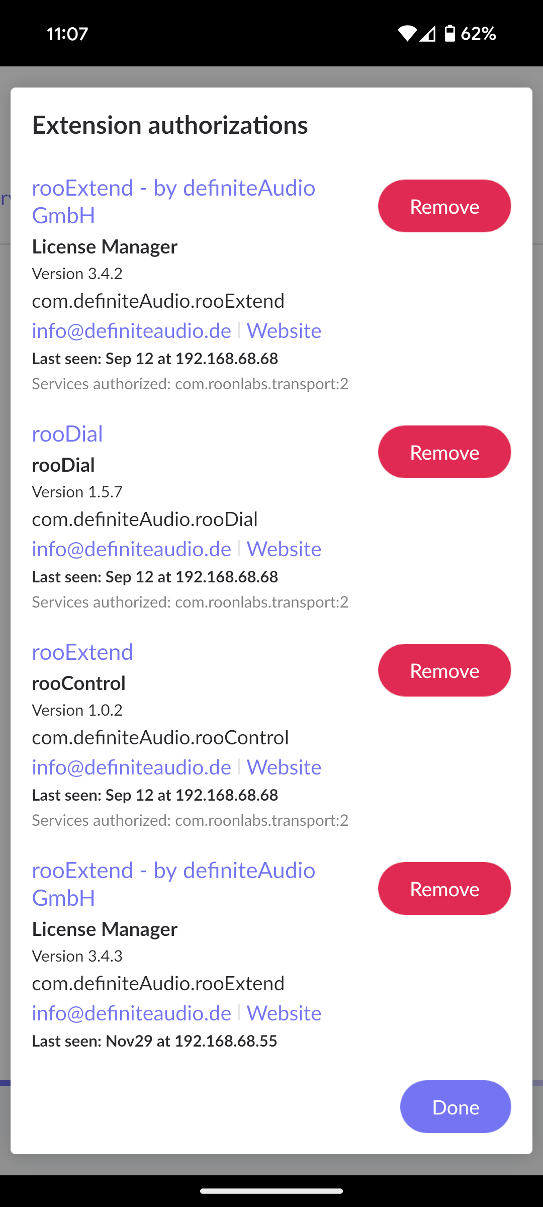

In the Extensions section of Roon I have the followingâŚ
Seems your SD-Card is worn out. Reflash it with the latest image and retry.
The Authorizations you posted are not relevant. They only show which Roon Extensions had been enabled in the past. Ir says nothing about currently active Roon Extensions.
