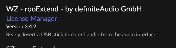

Hi @Jooxi,
rooMax will only show up if your rooExtend-Box has the latest Firmware and the USB receiver is plugged…
You can check this if you open Roon Settings/Extensions and lok for the rooExtend License Manager. Should be Version 3.4.2
The rooExtend-Box should update by itself at night between 2AM and 4AM. If it does not please download the rooExtend-Box manual from my Download Area. Starting at page 53 a procedure is described how to enforce an update.
Best DrCWO
