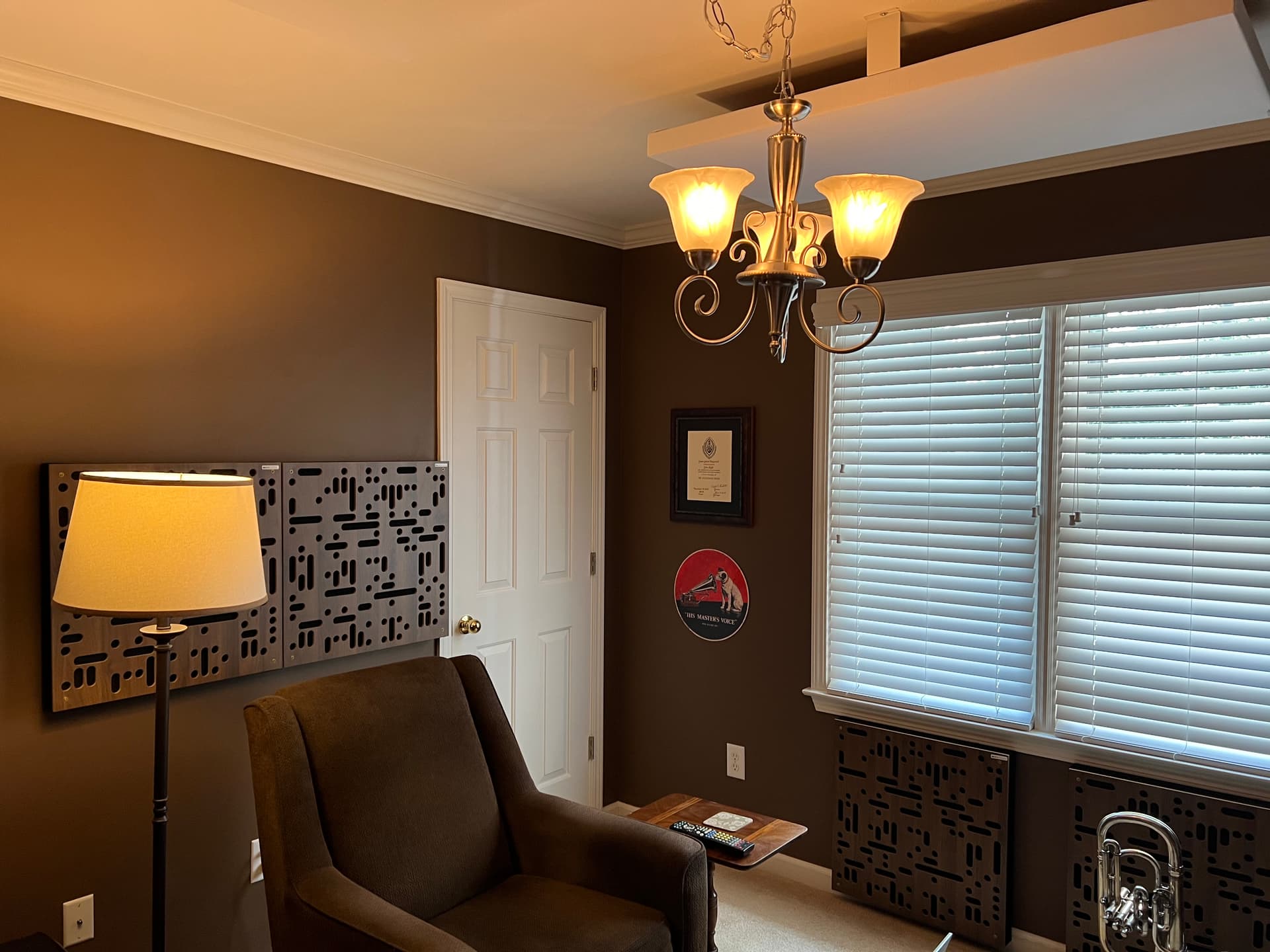

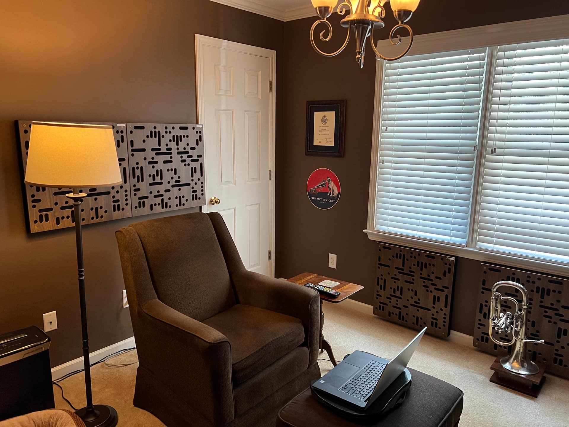

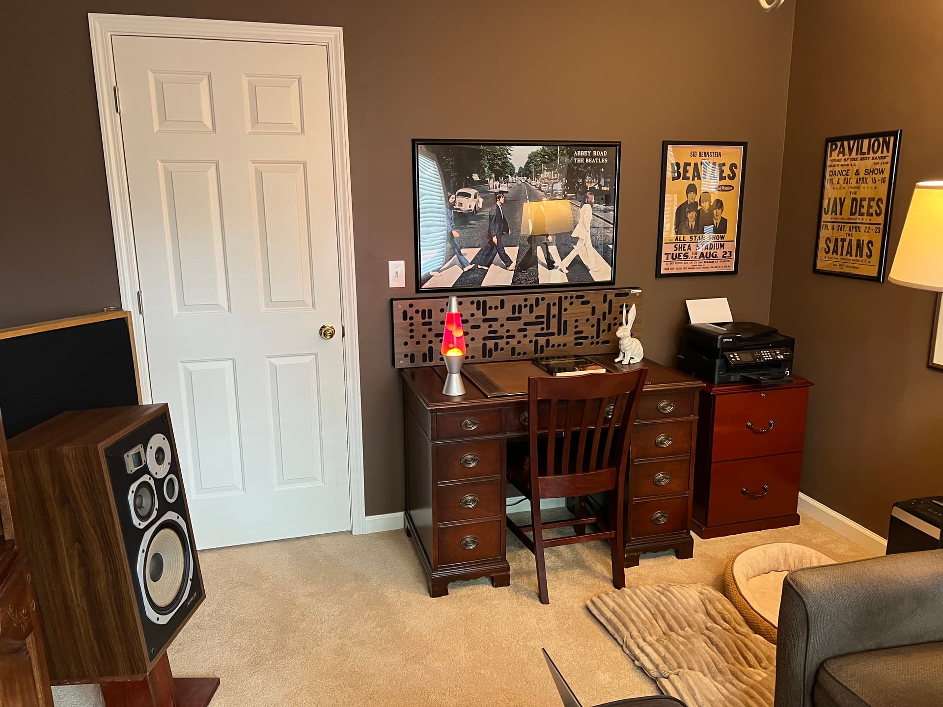

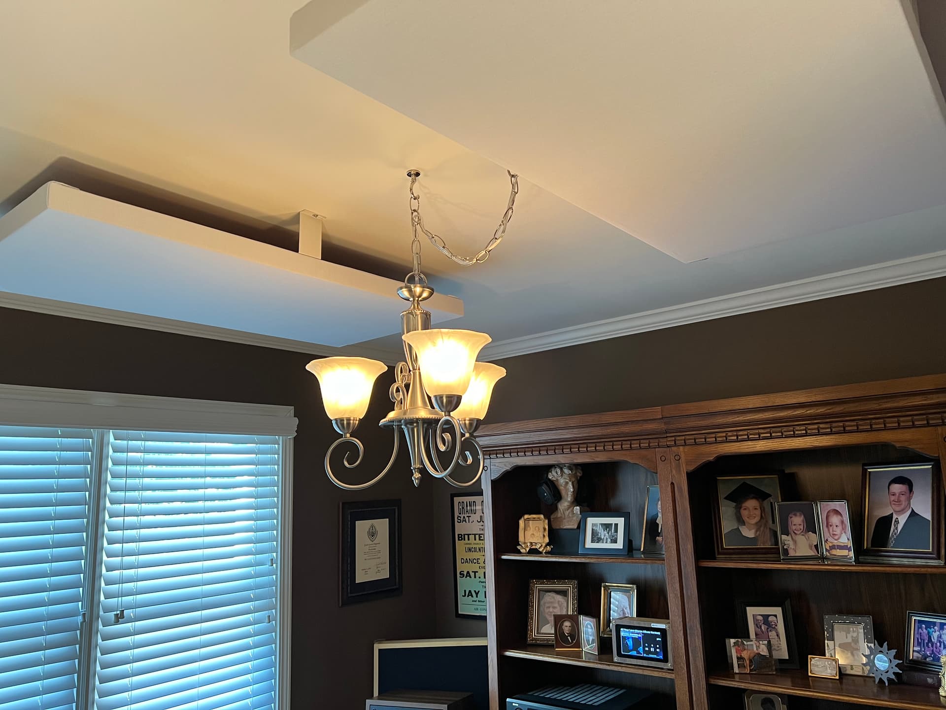

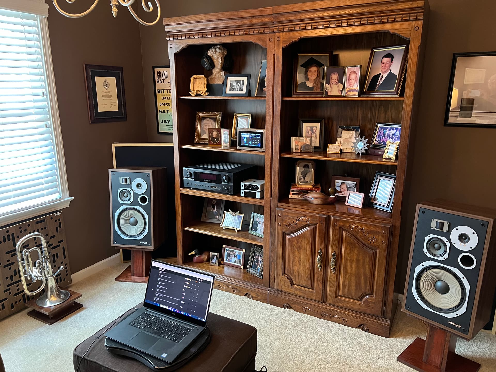

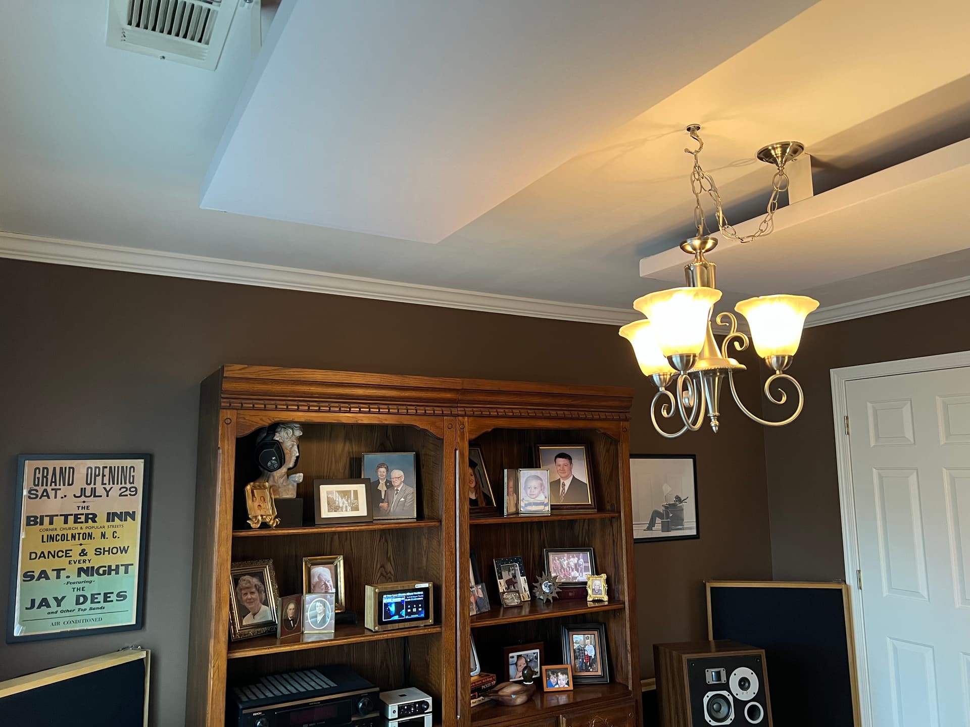

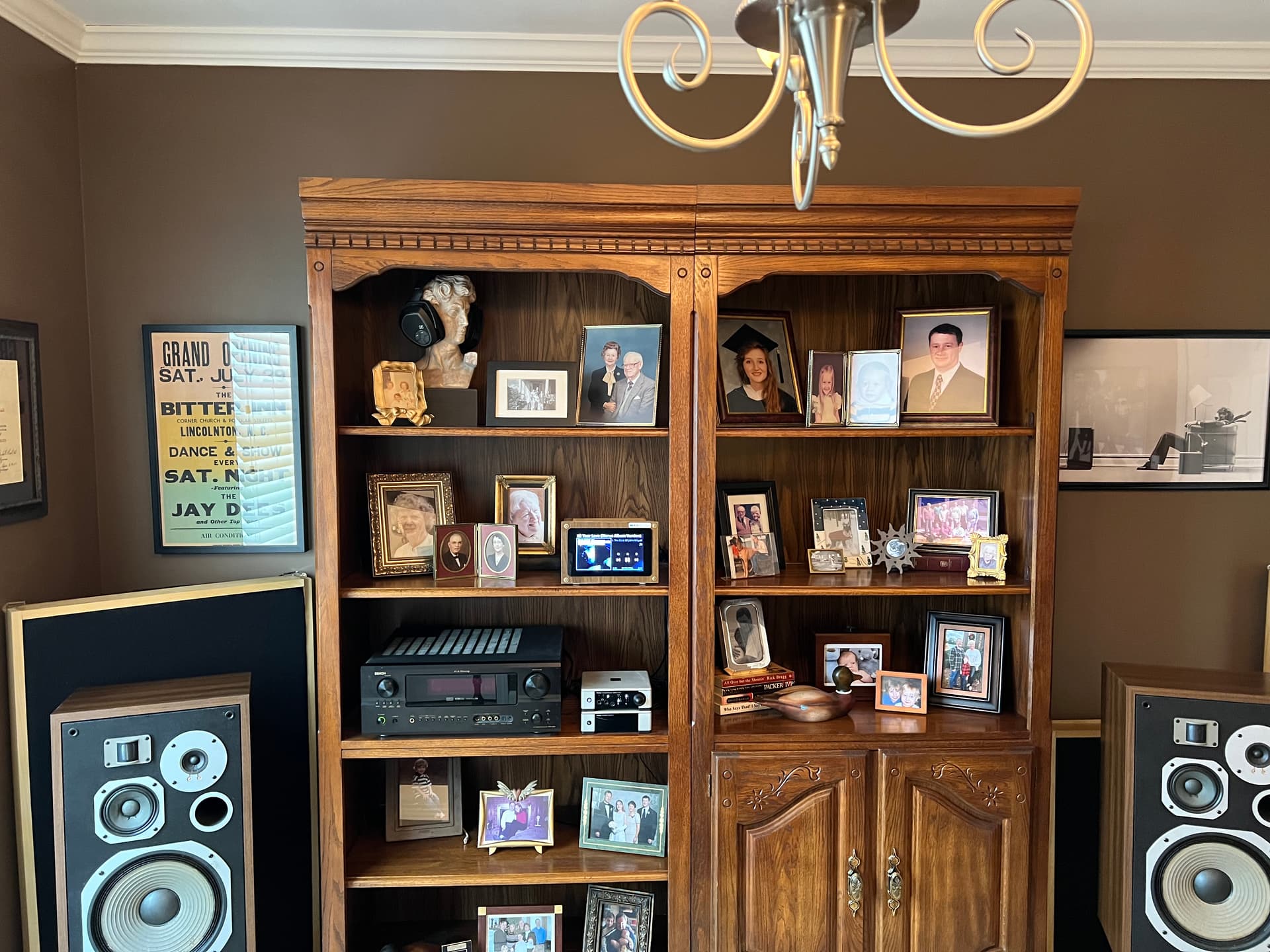

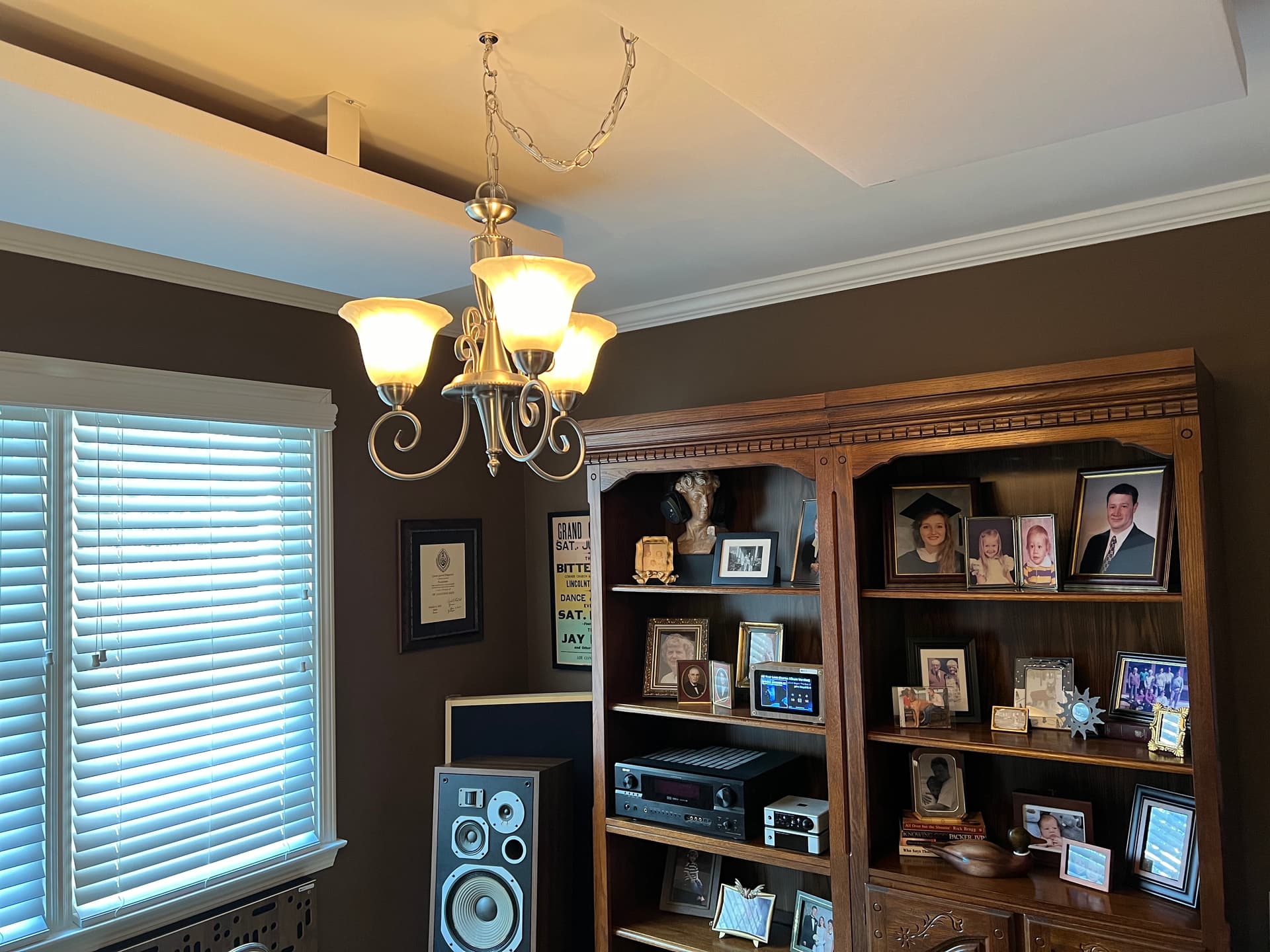

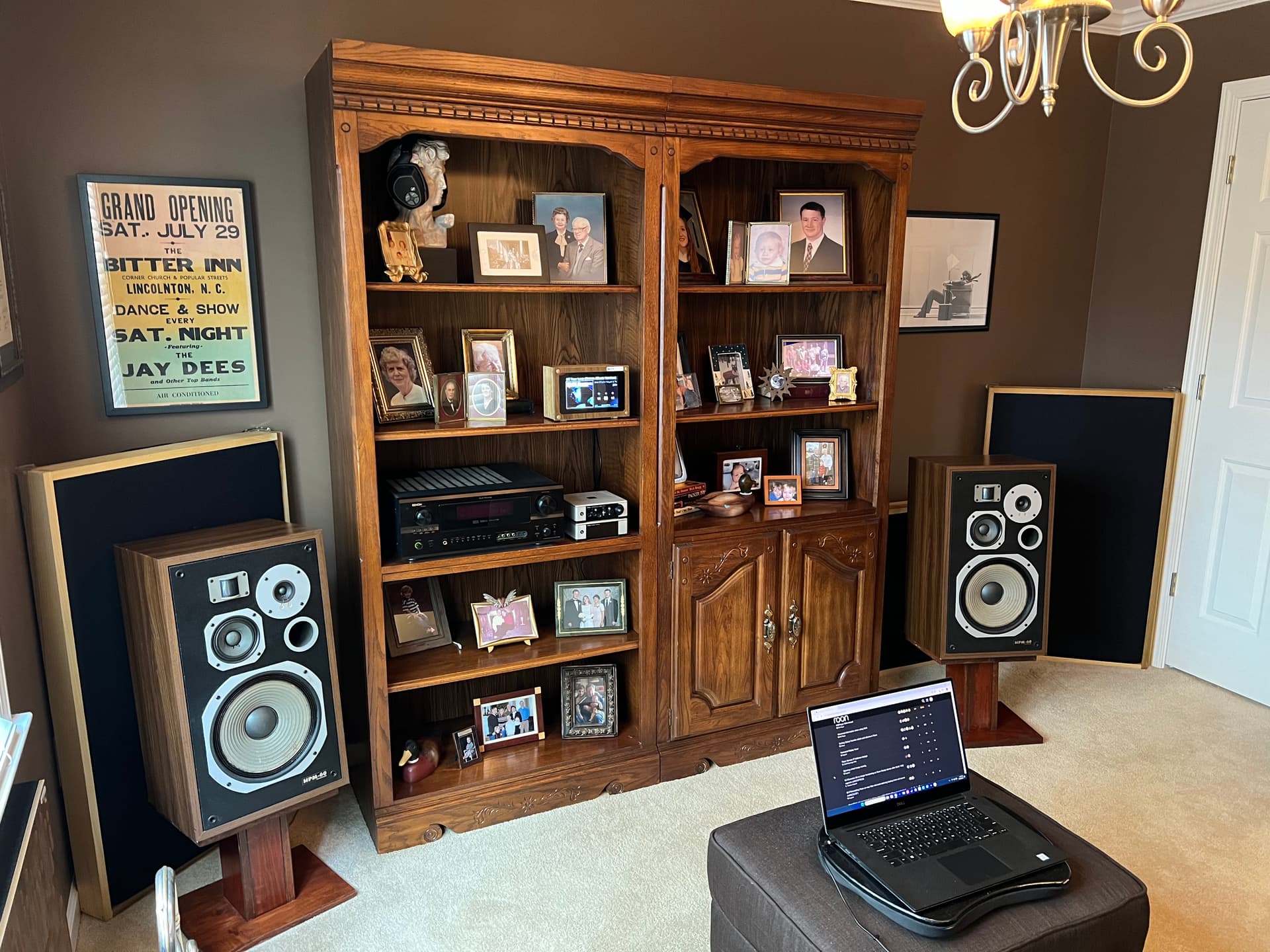

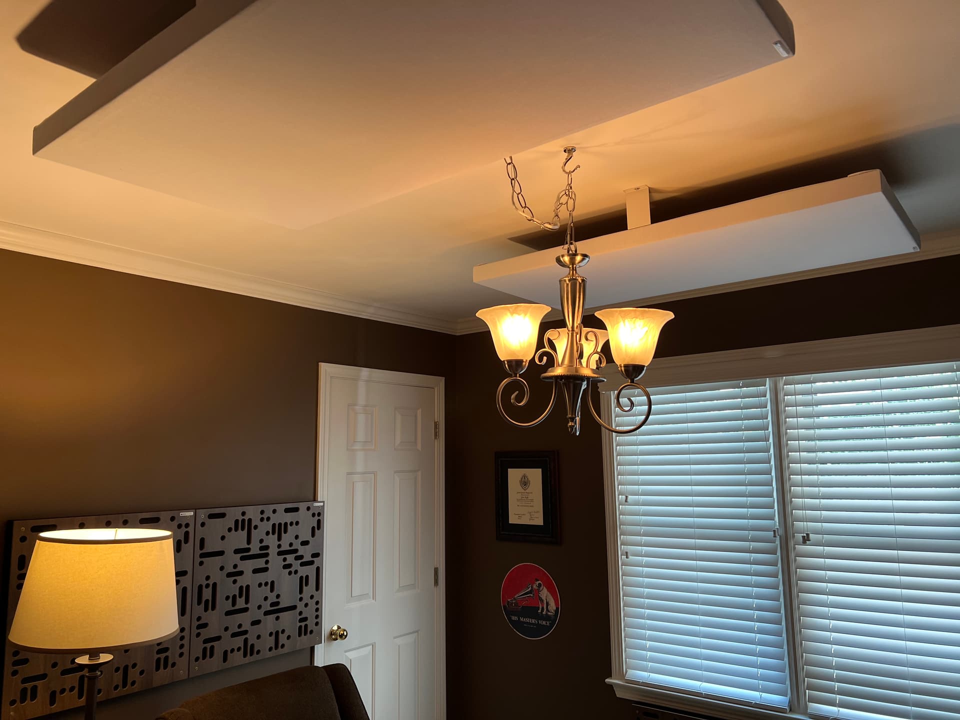

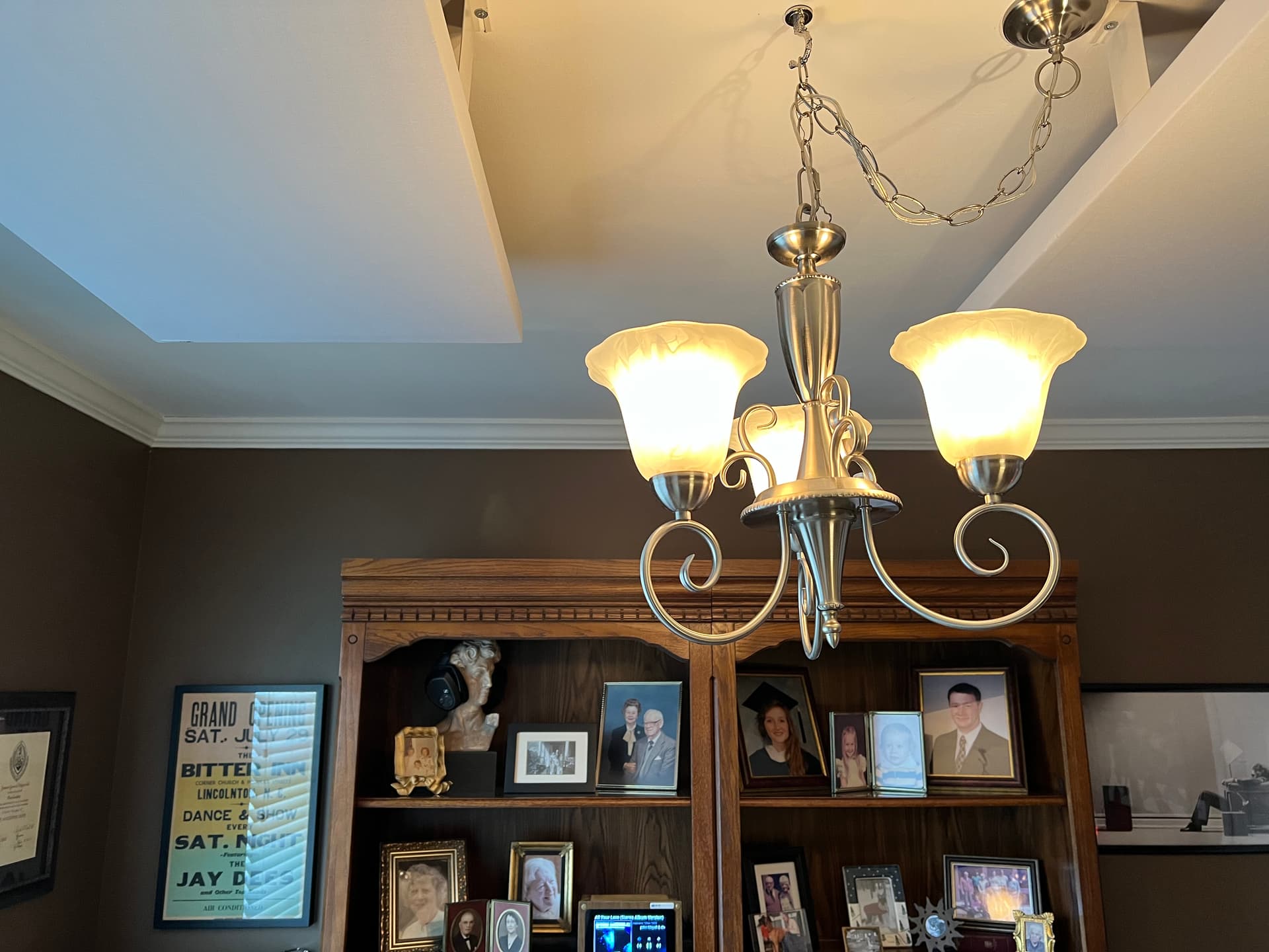

I built the bass traps and bought the other 7 panels from GIK.

Diffusion is much easier, I found the Vicoustic wooden diffusor panels aka multifusers (dubbed ´Tetris panels´) to be very good. But again, finding the right amount and position is key.
