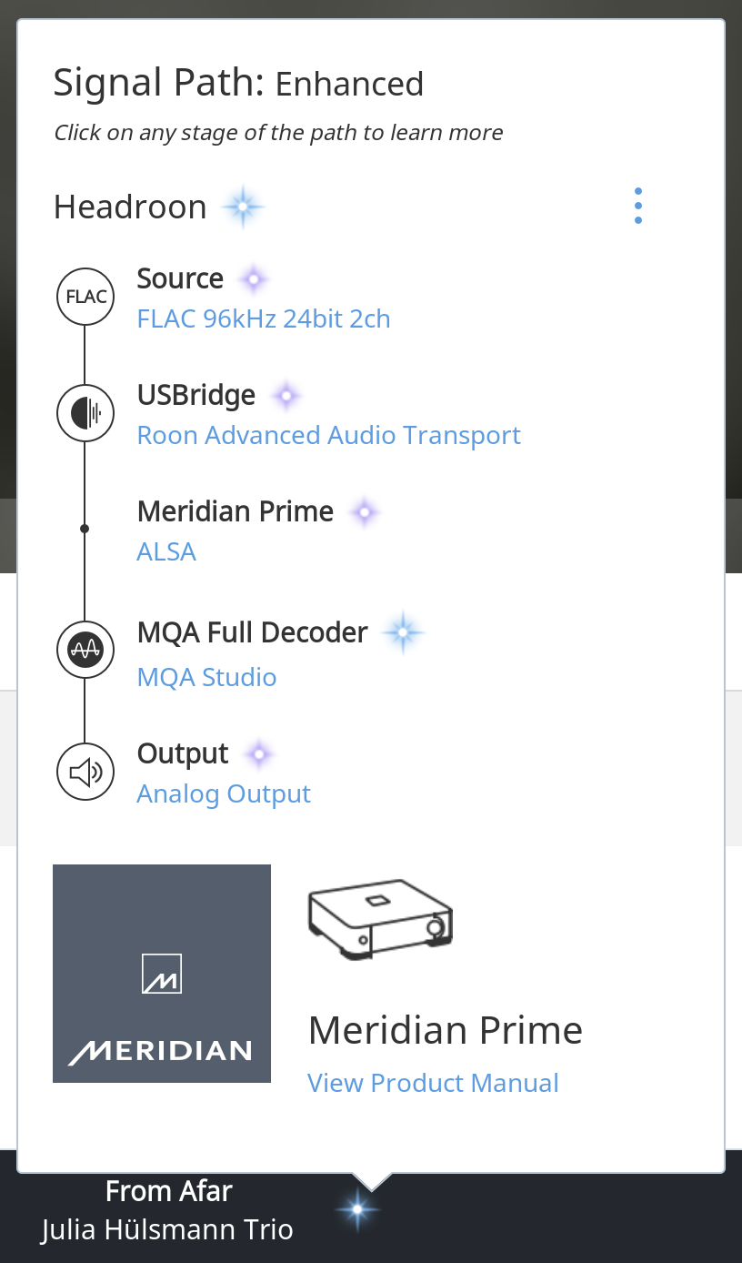

Hey @John,
I can replicate this behaviour with either an Explorer 2 and a Prime connected to my MacBook Pro.
I think it is cosmetic, as MQA decoding is obviously not taking place in the DAC when playing regular FLAC. Looks like the Meridian DACs getting stuck reporting MQA over USB HID.
Update: I can also replicate this on a Sparky/USBridge (with libusb-1.0 installed, so the entire path is visible):
