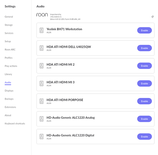

In addition to HDMI, there are three audio devices. I’m guessing the first is the system mixer, and the last, the audio hardware.
Try the ‘Analog’ device with exclusive mode.
i tried every device in the list all will be exclusive :frowning:
its just other devices like my monitor via hdmi or analog / digital output of my system
it even does detect my yealink headset for work … but even if i try to use this for listening its exclusive :frowning:

//EDIT1 i now tried connecting my DAC not via Optical but USB and still no matter what i choose its exclusive :cry:

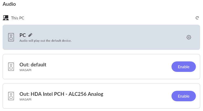

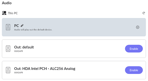

When you run Roon-on-wine, you can use the wine audio outputs in Roon. They do mix with other sound sources.

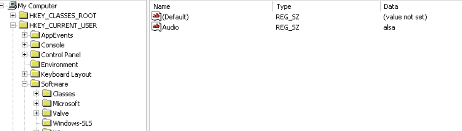

@robin246 YOU ARE A HERO !
i looked into the script:
which at line 104 only says:
_winetricks "Setting sound to ALSA" -q sound=alsa

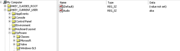

so i looked into my Bottles for that sound setting and found:
so setting:
[HKEY_CURRENT_USER\\Software\\Wine\\Drivers]
"Audio"="alsa" //or 'pulse' etc
and stopping the roon bridge on the system made Roon working as expected inside Bottles !
without any Alsa config changes to the host so it is even fully migrate able between backups :smiley:

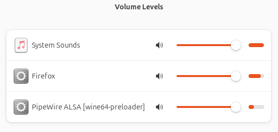

Finally after so many years of fiddling on and off this it currently looks like this small setting apparently fixed it :partying_face: :partying_face: :partying_face:

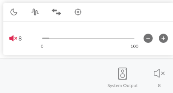

@robin246 is it possible to control the playback volume inside your roon? for me it currently is always 100% no matter where the slider is
this is playing at 100%
Filters / Crossfeed etc seam to work just the volume control looks stuck for now
A quick workaround is a de extension like this:

i use roon client inside bottles and with the registry tweak to get audio out of it
what is the specific problem you face?
//EDIT i use ftatpak bottles
runner is wine-ge-proton
