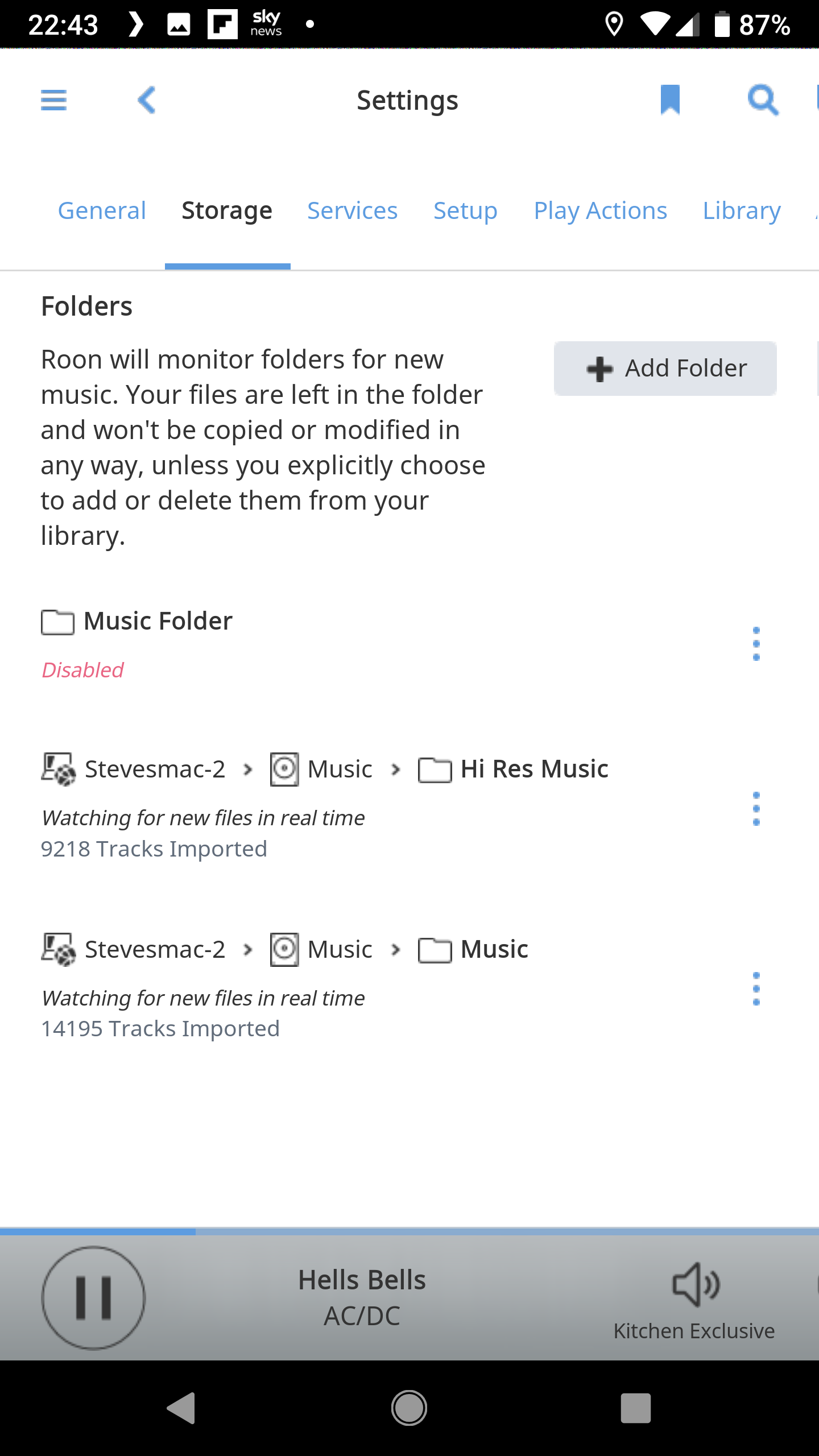

Additionally, it looks as though you may have some music stored internally on the MacMini. I was looking back through the screenshots of your storage tab and noticed that the “default music folder” is listed as an active watch folder and populated with content:
Upon setup Roon already knows where your iTunes library is* and where your operating system’s default music folder is and that is being reflected in the screenshot . I would recommend going to the “album” browser, clicking “focus”, scrolling all the way to the right hand side of the “focus” window, then choosing “inspector” followed by “storage location”. Select the “default music folder” and try to play content from that storage location.

The only change made since things were going right, was the update to macOS Mojave. The folder marked music, although not an iTunes directory, as I don’t use iTunes, does contain some odds and ends. None of which will play and when asking for file information all I get is the animated Roon logo.
System output does not work either, although should be no different to the Meridian Explorer attached via USB! In fact, while writing this I’ve gone back to Overview and that is now stuck at the animated Roon logo. It all worked perfectly a couple of days ago, now a real mess.IMG_20181101_220522|374x500
Ok. Update. I’ve disabled the internal music folder and cleaned the library up. I can now play local files, even though it takes a long time for them to actually start playing. Unfortunately, Tidal is still refusing to play.

Thanks @eric. Pleased to report that everything is back as it should be following a reboot of the Roon core. Local files are loading within a couple of seconds at most and Tidal is not far behind.
I moved my Roon core to a new machine about a month ago and hadn’t realised that the internal folder had been included in the set up. There must be something in there that was corrupting Roon. It is strange how it had a progressive effect on Roon by gradually slowing everything up until it came to complete standstill. Anyway now it is disabled and all is good with the world again. Many thanks for your patience and help.
