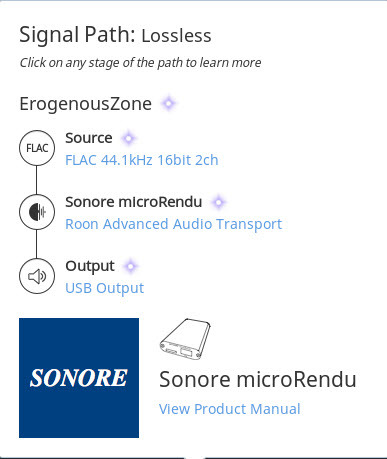

@Nick_Allen, Can you post a screen shot Roon’s Signal Path please, when you’re playing a track.

As you can see lossless bit-perfect from file to DAC, I think there’s some merit in your theory.
