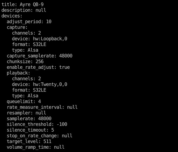

Here’s the way to do it.
Remember to enable ALSA loopback and install roon bridge by yourself.
Then you will find the loopback devices appear in roon audio endpoint list. (Try which loopback device works in your environment.)
Here’s my CamillaDSP GUI Configuration. Change the title and play back device to fit your system, too.
Will I still be able to use the same CDSP instance as the DSP for LMS as well or do I “waste” an RPi just to run as a roon dummy?
This will be a workable roon end point that passes through CamillaDSP, not a dummy one.
I am using my Pi4 as a shairport-sync device and a roon end point. But I will not play both concurrently at the same time. Therefore Roon bridge and shairport-sync can share the same loopback device.
I guess you have some applications that will use the Pi as LMS client and roon end point. And you will play both of them concurrently. Then you have to create two loopback devices. One for roon and another for LMS. Then mix them in CamillaDSP.
