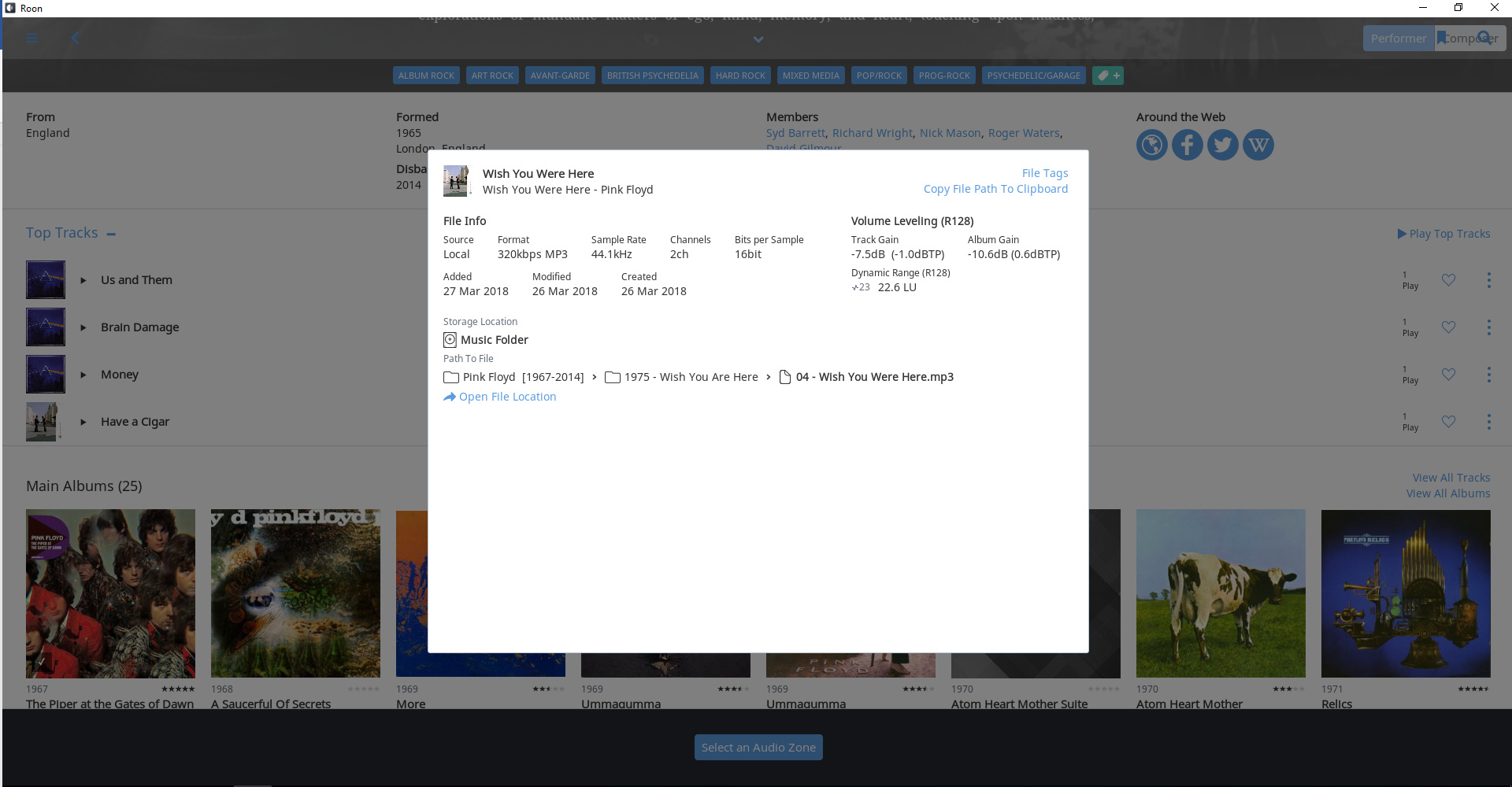

I’m not sure what the Music info you sent have to do with Roon. I would find one example of a track that appeared on Catalina but not appeared on Lion and right-click it -> go to the 3-dot drop-down menu and check the file path:
It is possible that you have additional storage options listed in Roon Settings -> Storage
that were not present before.
