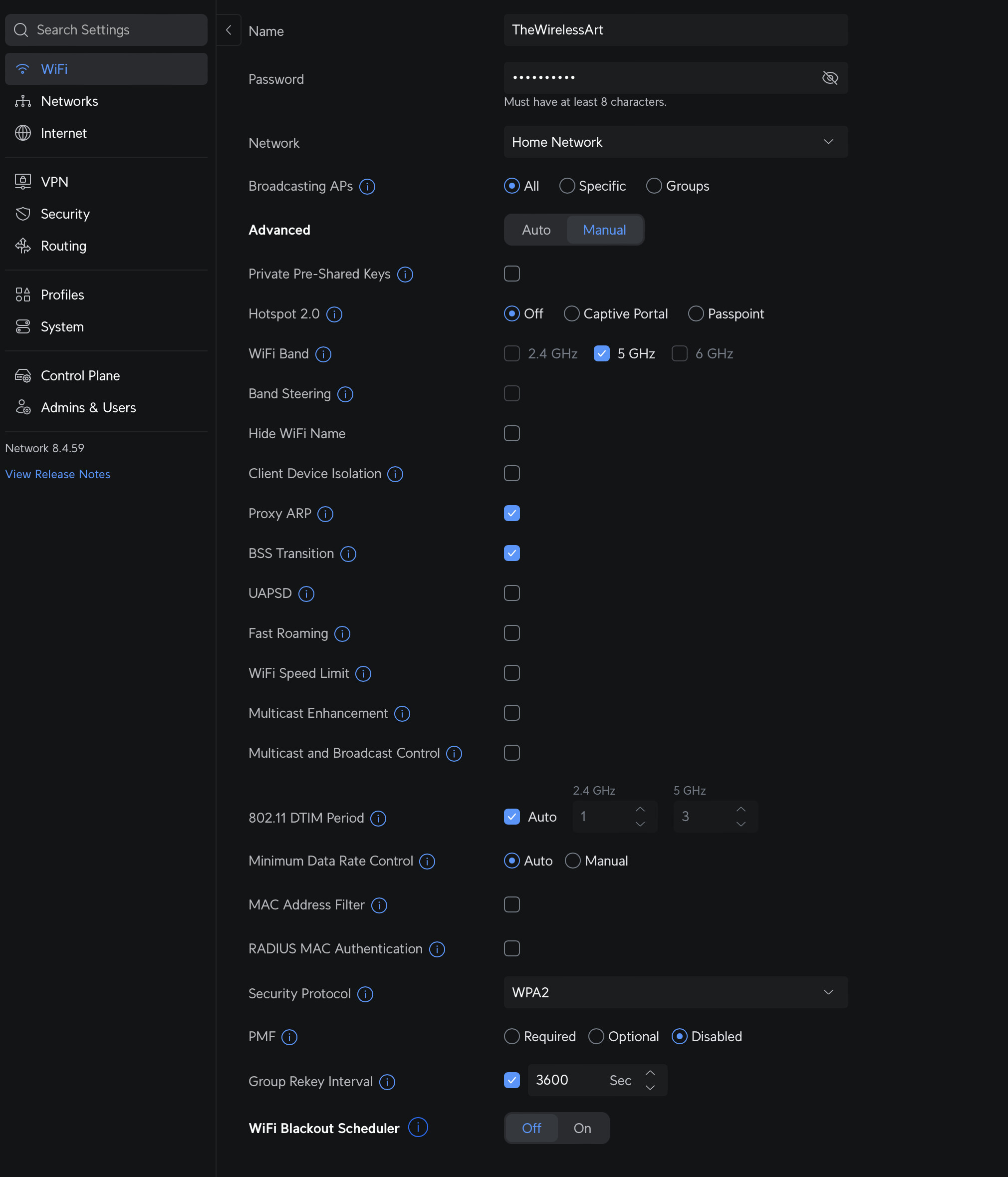

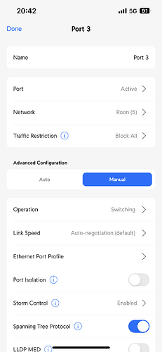

You need to set the ports to the required vlan, I don’t rely on tagging as I don’t trust all devices support it. So I assign the different ports on the switches to feed the devices the correct vlan. All trunk connections should be set to all so they transfer it all.

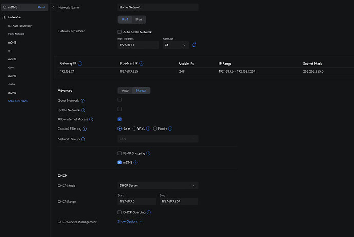

Networks set as corporate vlans
Roons vlan
Wifi vlan
Switch trunk feed
Roon devices
Also enable mdns or remote won’t work from another vlan.
