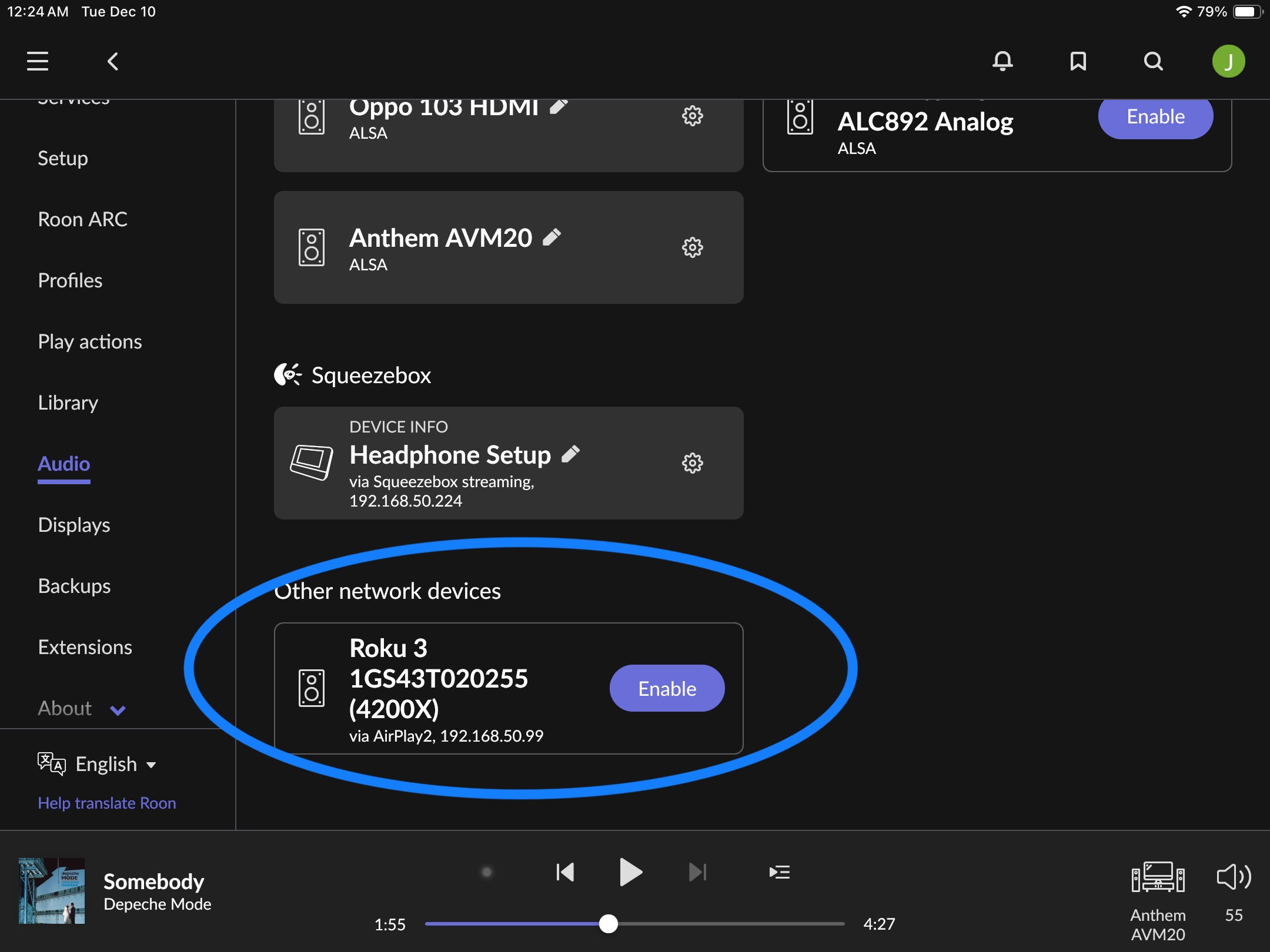

I can confirm that I have a Roku that is available as an Audio Device on Roon, via AirPlay.

My problem is that my Roku does not appear in my Roon Remote.

You should be able to connect to the Roku via Airplay
Hey @Ignacio_Arribas,
Are you able to share a screenshot of your Roon Settings>Audio?
We’ll need a more granular view on your local network setup, and how each device is connected to your primary router. I’d start off by simplifying any connections you have that include any switches or third-party gear.
Rebooting your router (if you haven’t already) would be helpful as well. We’ll be on standby for your reply! :raised_hands:
