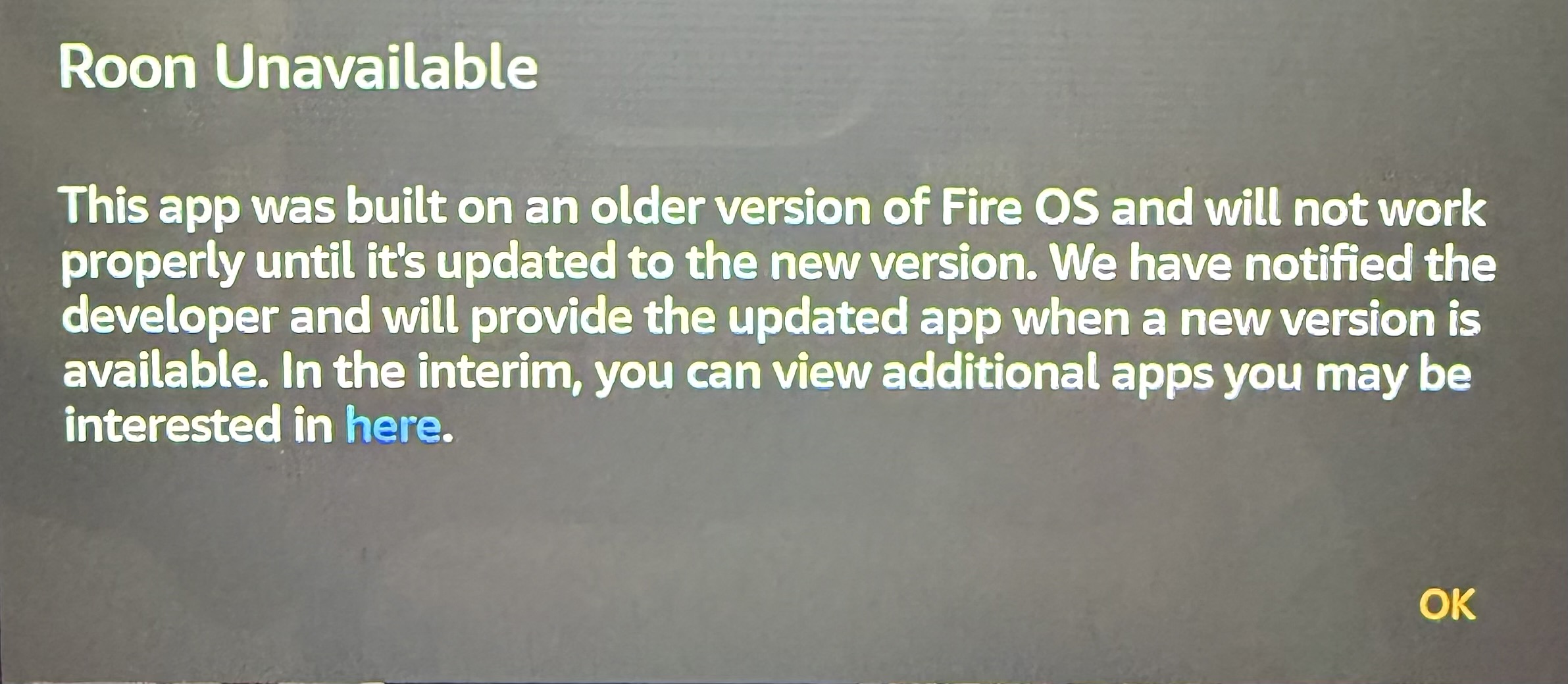

I am getting an error message on 2 of my 3 Amazon Fire Tablets as follows with the Roon app:
Roon Unavailable
This app was built on an older version of Fire OS and will not work properly until it's updated to the new version. We have notified the developer and will provide the updated app when a new version is available. In the interim, you can view additional apps you may be interested in here.

A few additional details - these two tablets do NOT work (they get above error message):
  1. Fire HD 10 Plus tablet (2021 release)
  2. Fire HD 8 Tablet 8" (Previous Generation - 8th)
This tablet works fine:
-Fire HD 8 Plus tablet, 8” (2022 release)
Thanks.

Hi - please see below:
  1. Fire HD 10 Plus tablet (2021 release - 11th generation)
    fire os 7.3.3.1
    build number: 0031575862404
    ***NOTE: This one now works! When I was checking System Updates, there was one waiting. So I installed it and now Roon opens Fine! So it’s just the one tablet below now that still doesn’t work.
    fire os 7.3.3.1
    ***no system updates to install - so still a problem
I install the Roon app via the Amazon App Store. Thanks.

Thanks for the repair. Up and running this morning. :slight_smile:
Mine also works now - thanks
