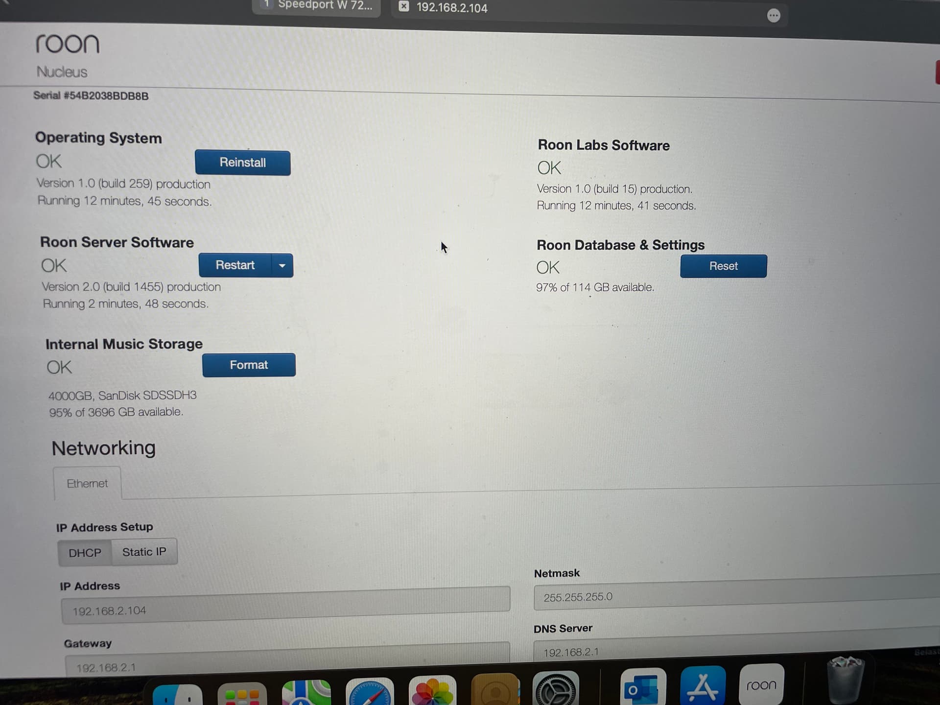

The Network is showing the Nucleus and I can access it via the internal Web page. All parameters are OK.
Nucleus Storage can be accessed normally and is showing ripped CD´s.

I connected a monitor to the HDMI output. Ande there are no error messages, just a black screen with serial number host name etc. look normal to me.
I hope this will help . Thanks in advance!
