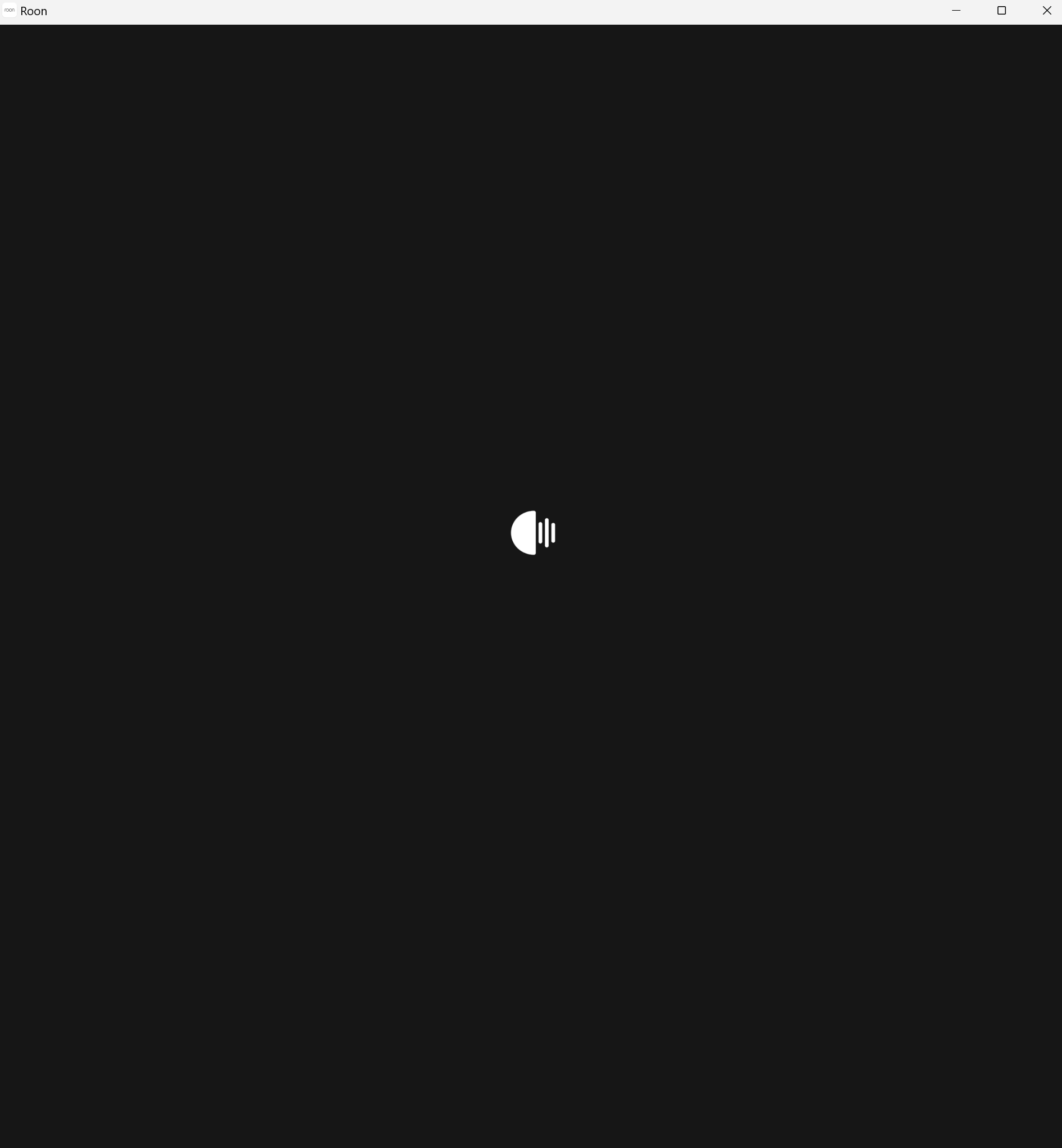

My Windows 11 computer had been running fine as my Roon core. It’s possible a recent update changed something, because now the Roon application will only “open” and show the loading logo but never actually enter the application. I have checked my firewall exceptions for all .exes, which have not changed, and it seems everything should be working..

Hi @Jay_Berget ,
Thanks for reaching out and sorry to hear about the issues you are facing. Can you please confirm, do you see RoonServer as running in the taskbar, and does the status show as running? Can you access your manual Roon + RoonServer logs by using these instructions and upload them here? Please send both Roon and RoonServer logs so that we can try to determine the failure cause. Thanks!
Hello, yes, the Roon Server is in the taskbar and status is “running”. I uploaded my log files to the server. Thanks for your help!
