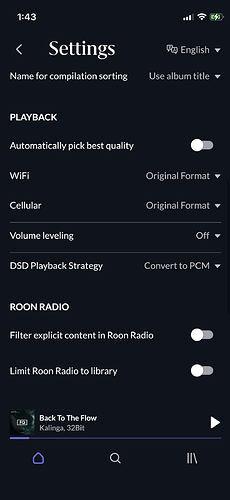

Can you share your playback quality settings in ARC?
It converts to 24-bit, CrystalGipsy, when used as an endpoint in Roon (not ARC). I’ll provide the signal path in just one moment.
Here are the playback settings, Marian.
Thanks. As far as I can tell, it should work the same as for non-ARC, so this seems like a bug in ARC.
