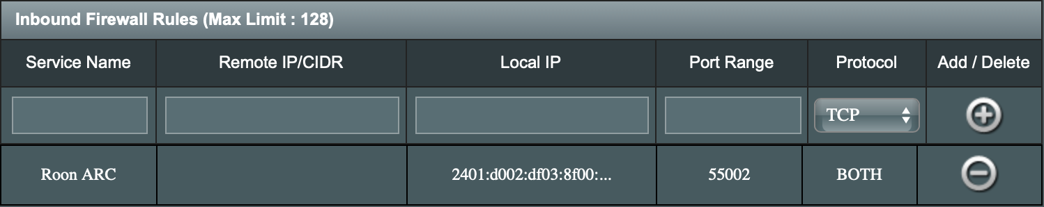

This is the IPv6 firewall rule I set up but I’m not sure I have done it correctly, do I need something in the Remote IP/CIDR box and if so what?:

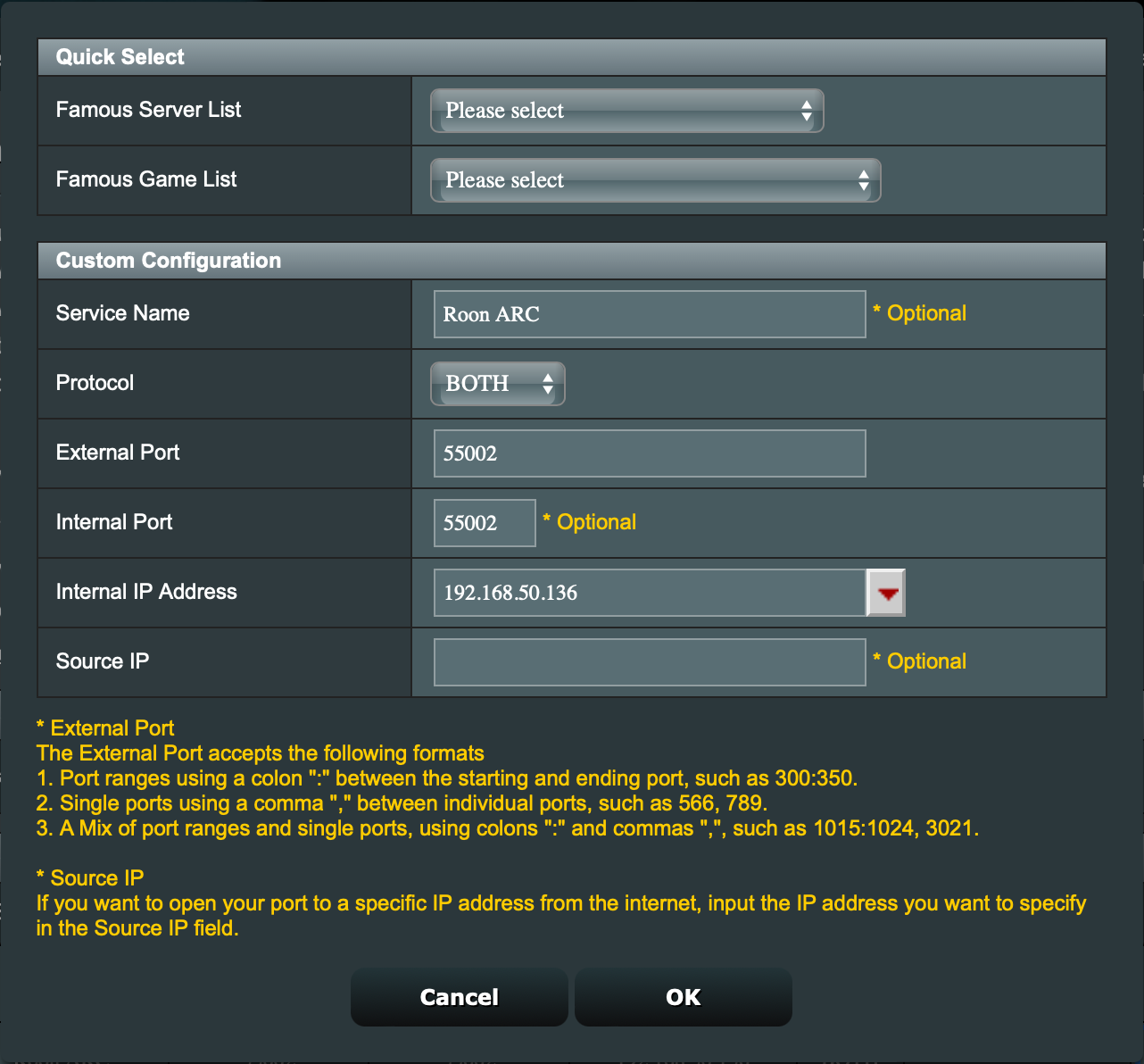

I have also tried with and without the old Port Forwarding Rule that was set up and worked with my previous ISP.

Your IPv6 firewall pinhole configuration is fine.
However, you don’t need to open the port for ‘BOTH’ UDP and TCP… Only TCP is required for ARC.
The fact that you know IPv4 is not working because of CG-NAT but Roon is reporting ‘ready’ in the Roon ARC settings page tells you that the IPv6 firewall is correctly, or at least adequately, configured.
