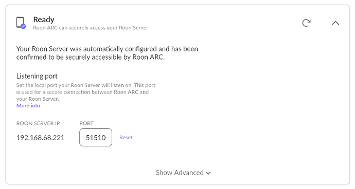

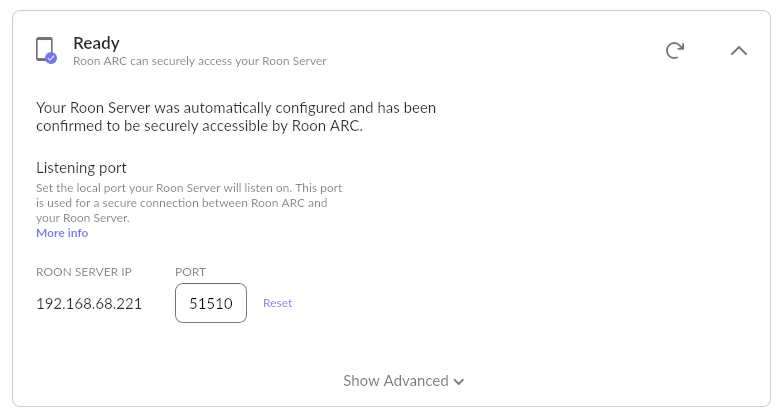

I have my Roon core installed on my Apple iMac. It all works perfectly on the roon endpoints in my home. Also, on the Roon ARC tab in the interface, it says “Ready” and that “Roon ARC can securely access your Roon Server.” Also, I have the Roon ARC app installed on my iPad and iPhone, and both said that they synced with my Roon server.
But when I open Roon ARC whenever I am away from home network, either on my iPad or iPhone, it wlll not connect and I get a message that my Roon server cannot be accessed.

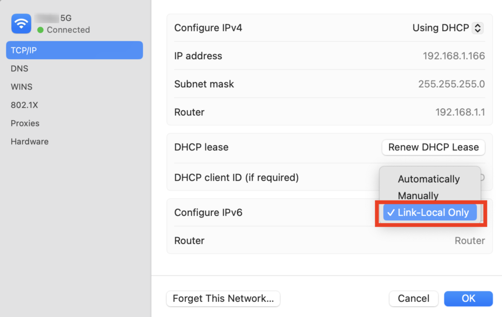

How do I disable “IPv6” in my Mac network settings. I don’t see it anywhere. (Is it the same as disabling the wireless connection?)

The instructions may differ a bit depending on your exact Mac, but please see below on how to disable IPv6 and let us know if this helps, thanks!
  1. Open System Preferences and click Network.
  2. Select your network connection on the left, then click Advanced on the right.
  3. Go to the TCP/IP tab.
  4. Next to Configure IPv6, select Off from the drop-down menu.
  5. Click OK, then Apply to save the changes.
  6. Repeat the same steps for any other network interfaces you want to disable IPv6 on, like Ethernet.
How to turn off IPv6 on Mac?
When I get to the Configure IPv6. tab, I am given 3 options. - “Automatically”, “Manually” and “Link- Local Only”.
I am not given the option to turn it “Off.” What should I do?
Can you help with this?
Hi @Jack_Cobetto ,
Please give the Link-Local Only option a try, it seems like Mac changed the option in later releases:
