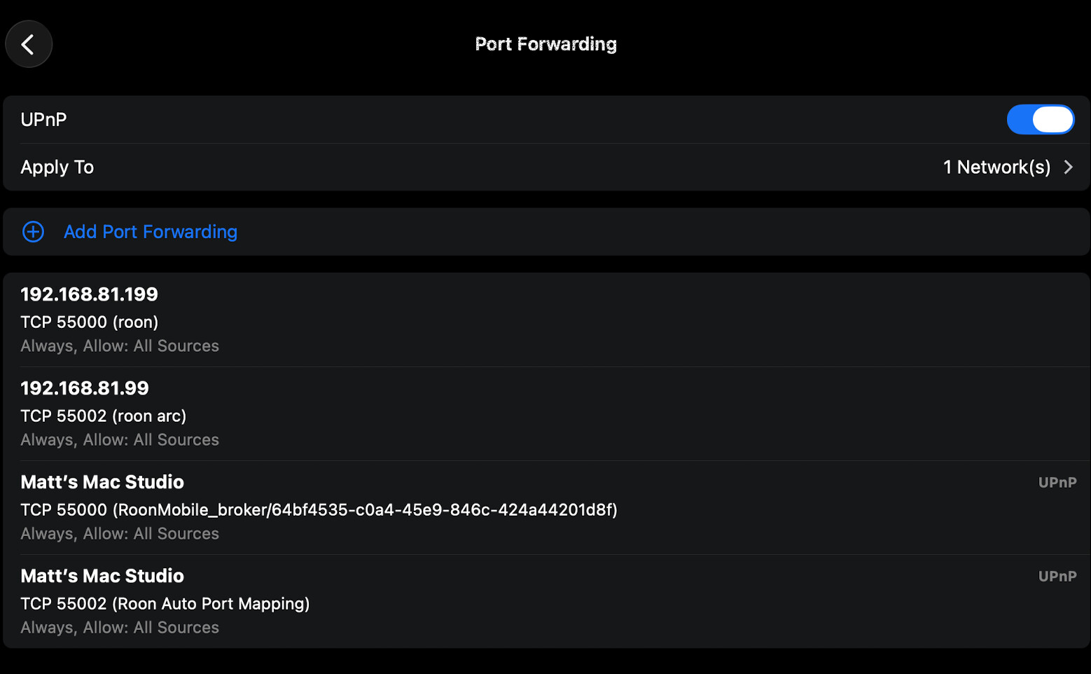

· Router/Firewall is a Firewalla Gold. Cisco Switch F236F5. Then Mac Studio. All connected via ethernet. I have a wireguard VPN through the Firewalla router as well.
Here’s a screenshot of the UPnP settings in my router

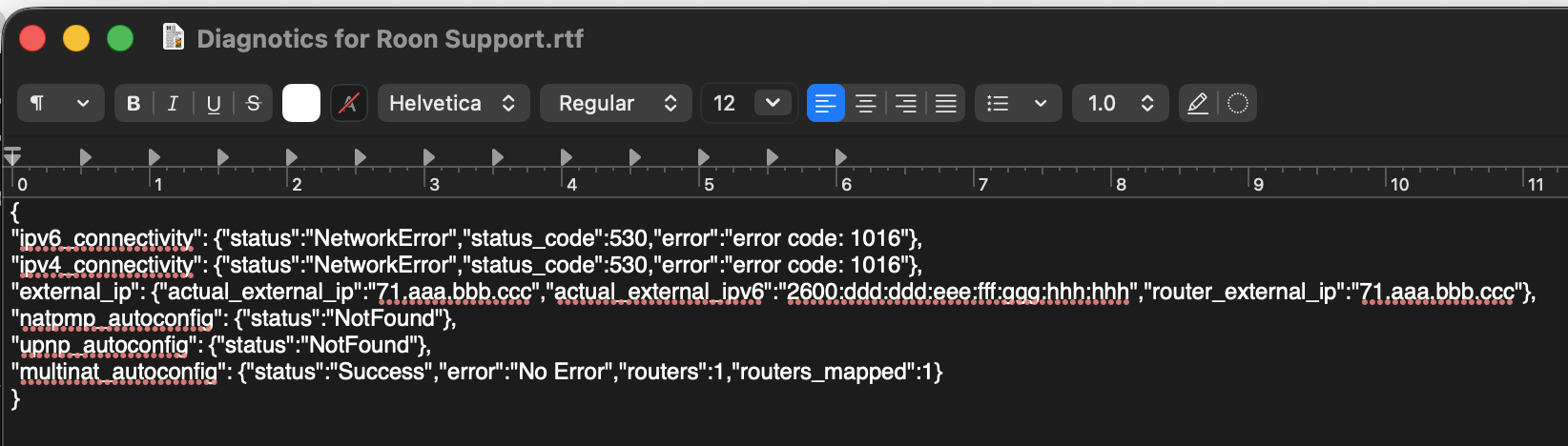

Your diagnostics show “status_code”: 530 and “error code: 1016”. These errors indicate a temporary issue with the cloud infrastructure provider (Cloudflare), which is preventing your Roon Core from successfully running the connectivity test.
Please give it some time and keep an eye on the status page: CloudFlare Status Page
Because the test itself is failing to reach our servers, the “Not Ready” status and the UPnP errors you see might be misleading. Your actual connection configuration may be fine.
