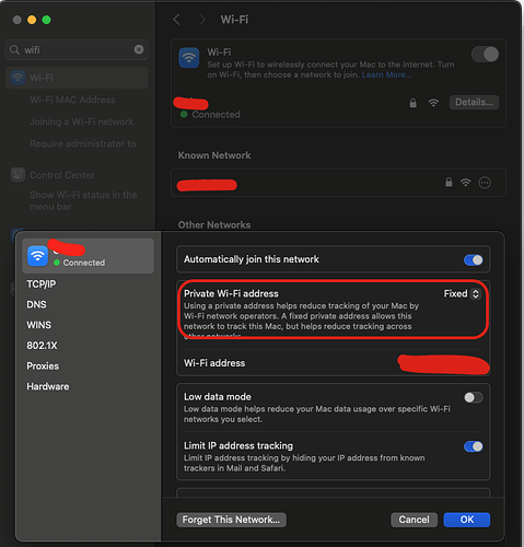

Hi @staale.andresen ,
Can you please check to see if this setting might be interfering by any chance?
I would try to set it to Fixed or Off and see if that helps. Let us know!

Hi Noris, I tried this (though I normally use LAN), but it did not work with WiFi either, nor with “Fixed” or “Off”. I mentioned earlier, that I have a suspicion, that the Apple “Privat Relay” may have something to do with it, although the Roon ARC does not work with the “Private Relay” on or off, but I have had some problems with other services, because of this.
