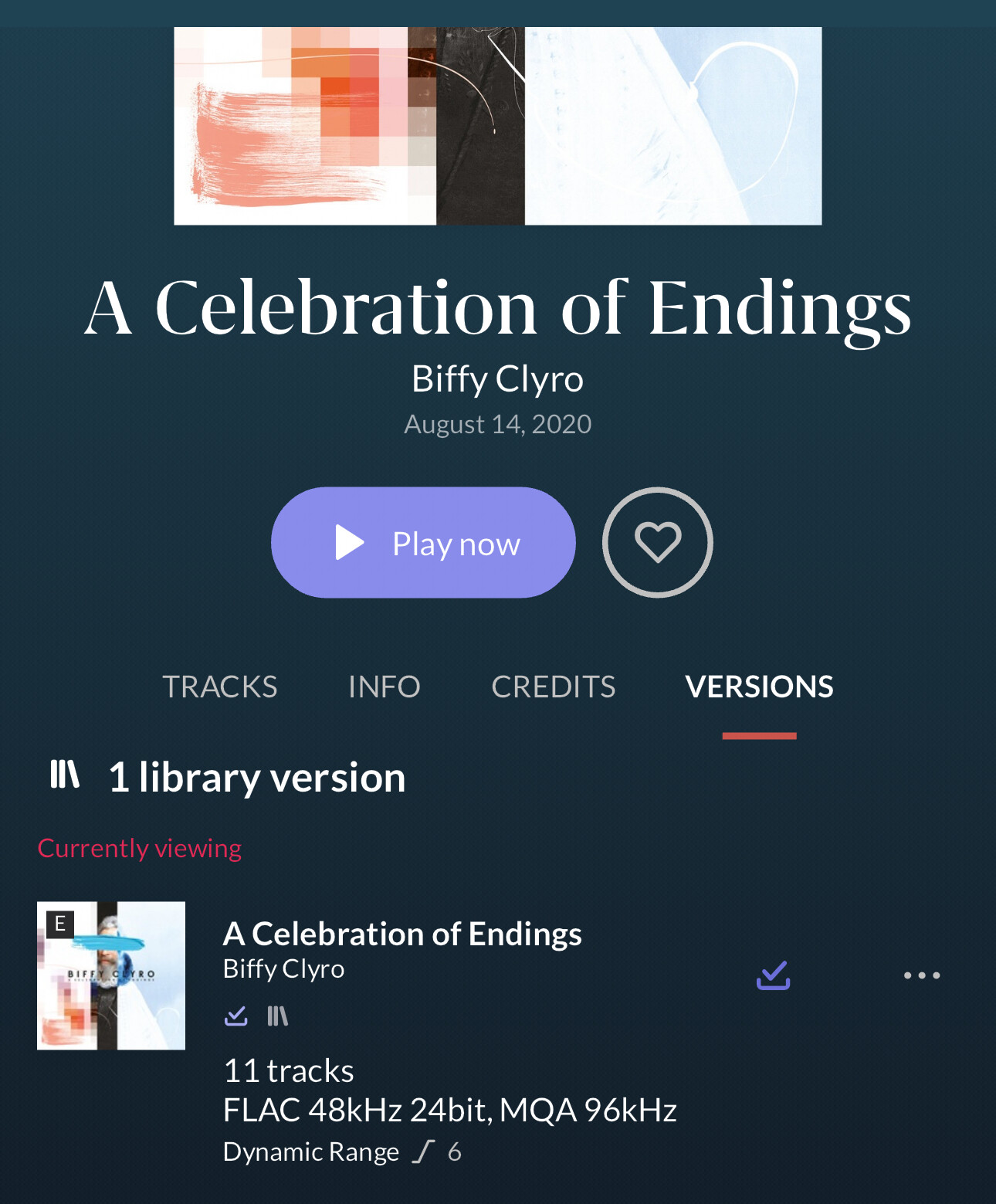

I found something strange: while on the downloads all the albums appear to be 44 or 48 getting inside I found some (but not all the greyed out) to be 48 and MQA 96.
Check this out:
Anyway, it’s a problem I can easily solve with a clean download at CD quality. There must be something in the transition that did not work as expected.

Looking at all the version I found an interesting behavior:
  • Looking at the storage location in Roon I had 2 path, which we will call path1 and path2.
  • having path 1 was disabled, since long long time ago.
  • So even though when I downloaded the songs on my phone this path was already disabled some of the albums greyed out showed 2 version downloaded: 1 version from path1 and 1 version from path2. (you can check the screenshot:)
* Removing the path1 version of the album the problem is solved.
