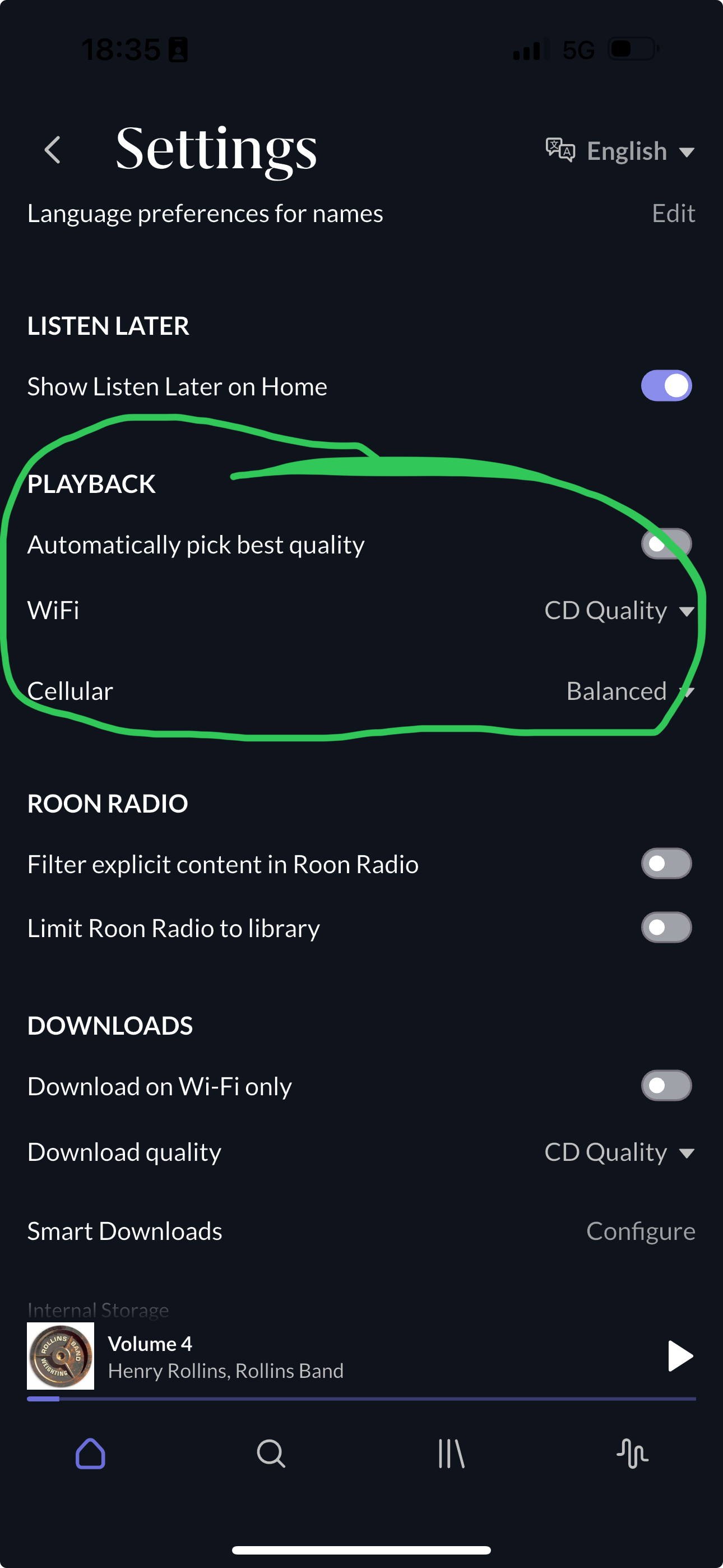

ARC, being primarily intended for mobile playback, has additional settings for converting music data to lower bandwidth, which are enabled by default (but can be disabled)

If format conversion and DSP is off, then both ARC and main Roon are bit perfect.
In addition, ARC uses larger buffers, again to increases mobile (primarily cell network) reliability
