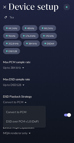

What do you have selected under “Playback” in the ARC settings page?

Hi Connor,
Below are the settings.
I have selected the DoP setting
Hi @Patrick_McGuire1,
Thanks for that!
