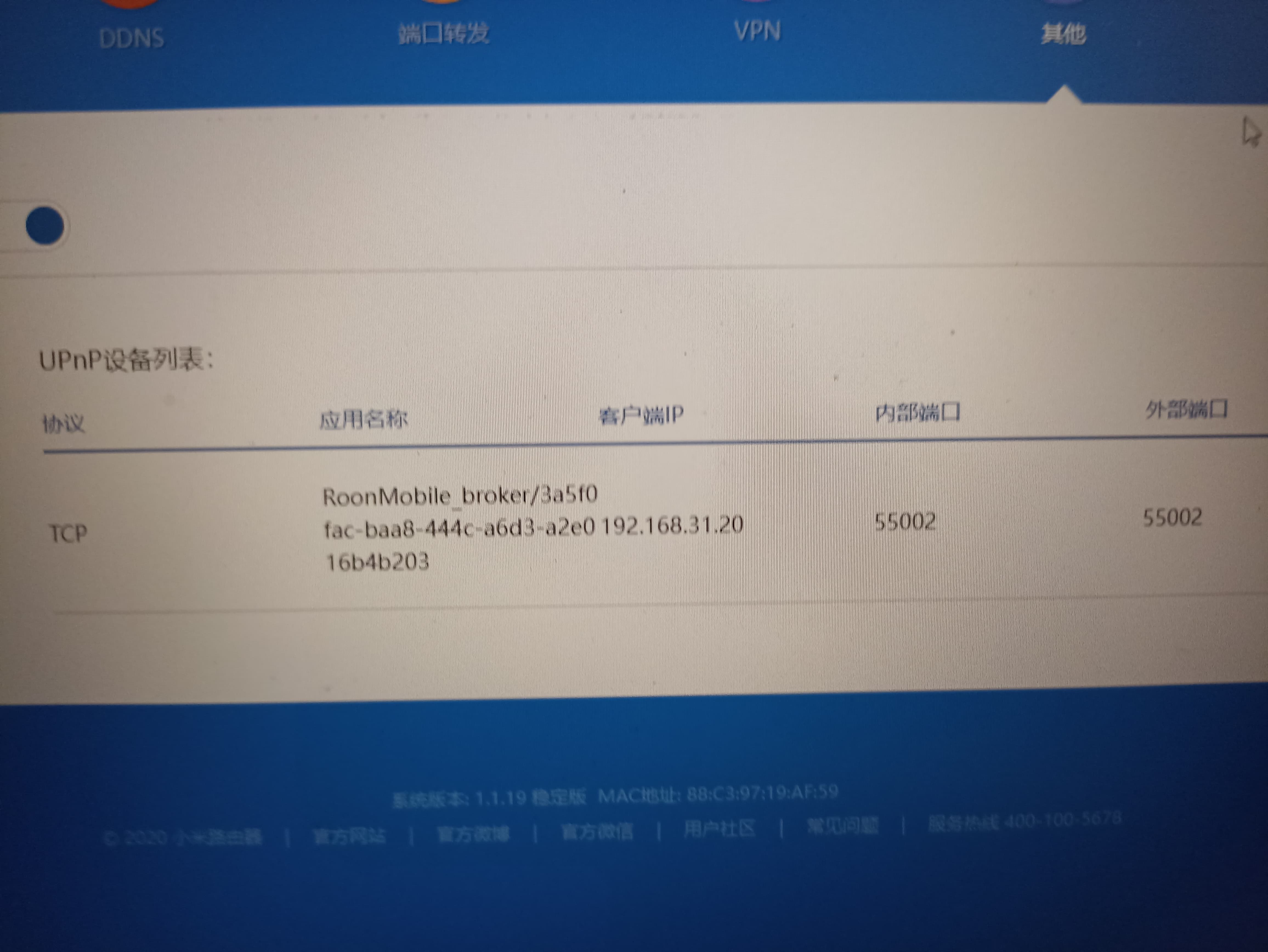

“ipv4_connectivity”: {“status”:“NetworkError”,“status_code”:504,“error”:“error: Error: ETIMEDOUT, response code: undefined, body: undefined connected? undefined”},
“external_ip”: {“actual_external_ip”:“219.aaa.bbb.ccc”,“actual_external_ipv6”:“null”,“router_external_ip”:“192.168.0.10”},
“status”: “status”: MultipleNatFound
“upnp_autoconfig”: {“server_ip”:“192.168.31.1”,“found_upnp”:true}

This is the problem.
There is more than one network address translation (NAT) layer active, preventing port forwarding from working although the port forwarding on the router is configured by UPnP.

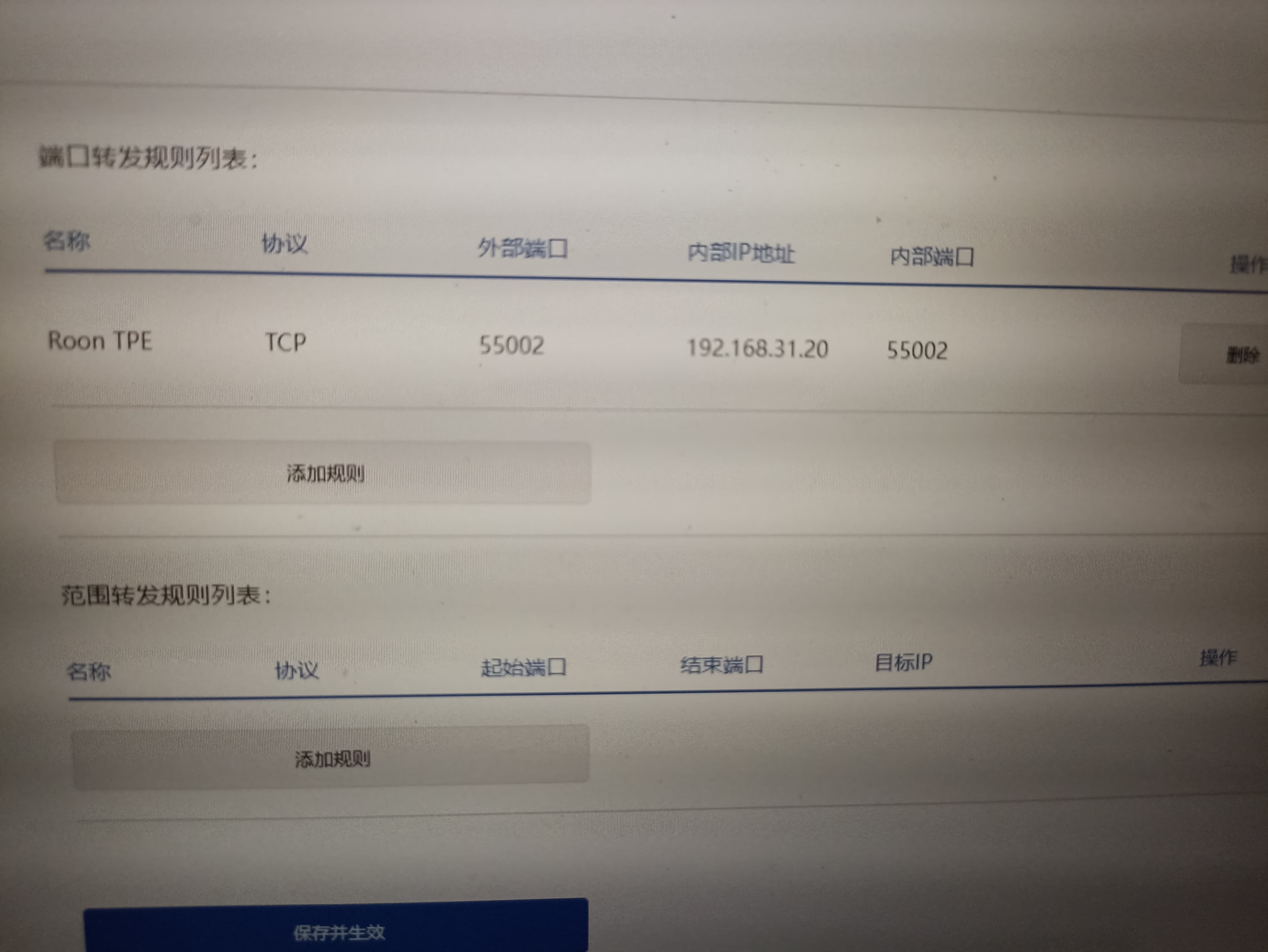

The problem solved after add port forwarding in the modem router. Thank you and appreciate your quick response and help.
