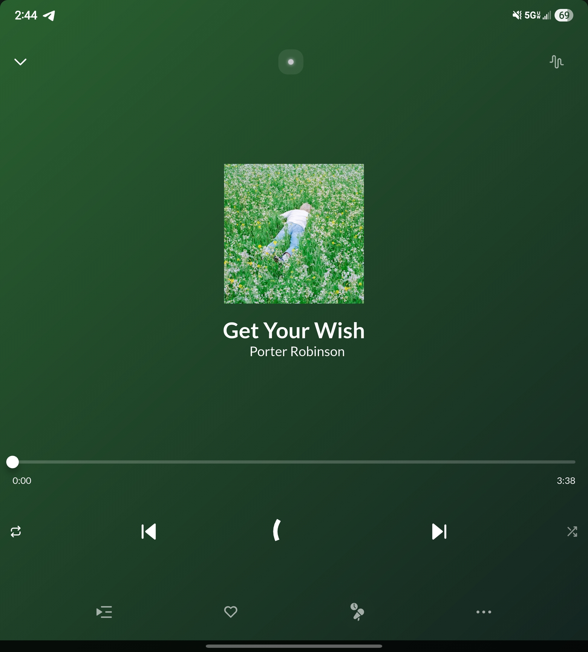

This is a follow up to an existing post that I made in June, regarding an issue with ARC where playback of Qobuz tracks in ARC on mobile data will break after one song.
Toggling airplane mode will fix the issue for a song or two, then playback will break again. When this happens, roon will show the progress indication on the play button before eventually giving an error of "poor connection". I have since switched to a Fold 7 and still see this behavior, but occasionally if a qobuz album is played without skipping around, playback works for a few tracks.
I've popped my Sim back into my iPhone 13 Pro and can confirm playback still works fine on iOS.
