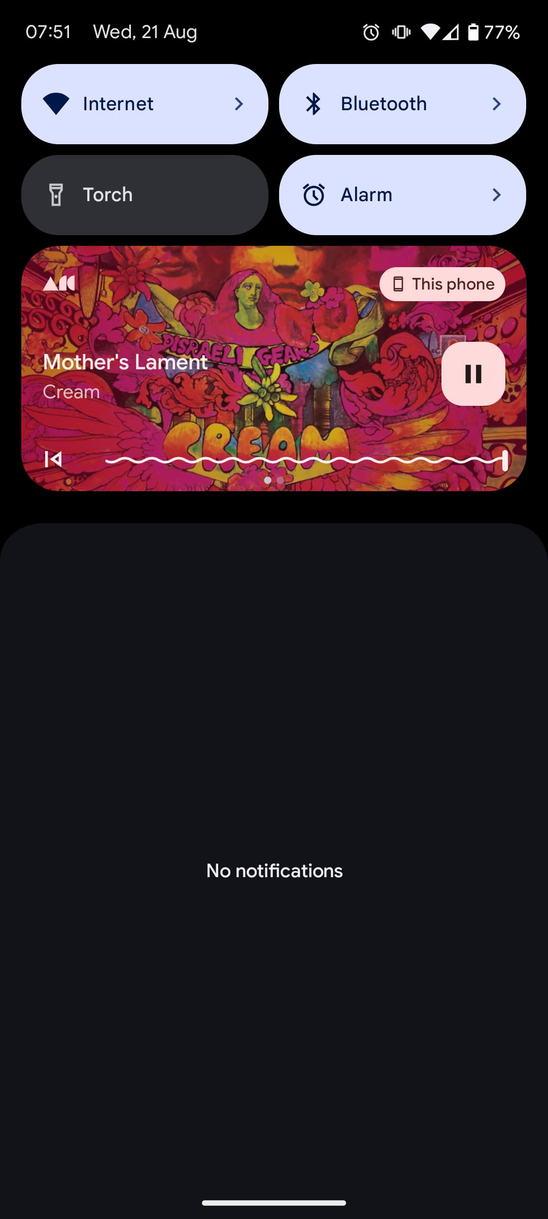

Arc 1.0.57
Even after playback in Arc has stopped, the notification remains in a playing state

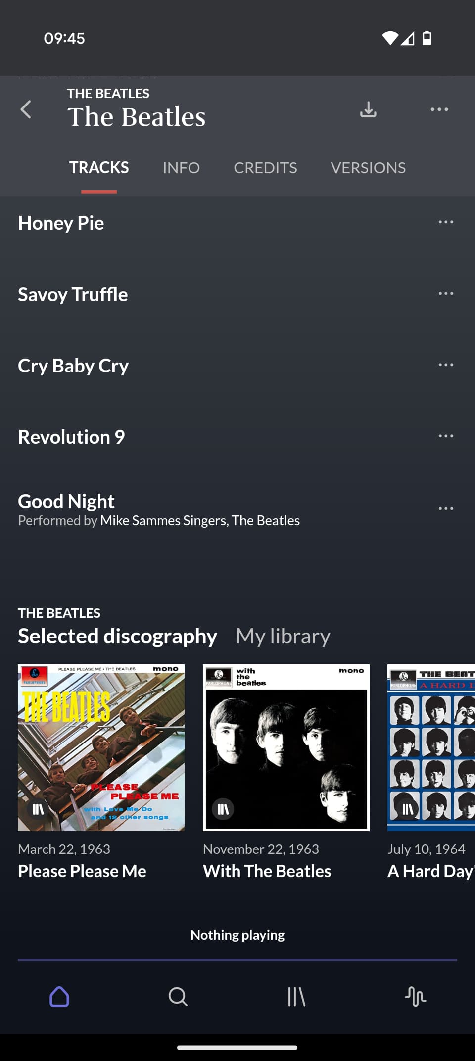

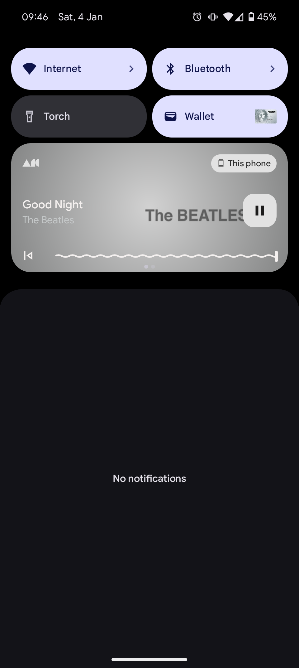

The notification stuck in playing state is still an issue for me. To reproduce I did the following
  1. Played the last song on an album (The Beatles in this example)
  2. Wait for it to finish (note how the bottom bar says Nothing playing)

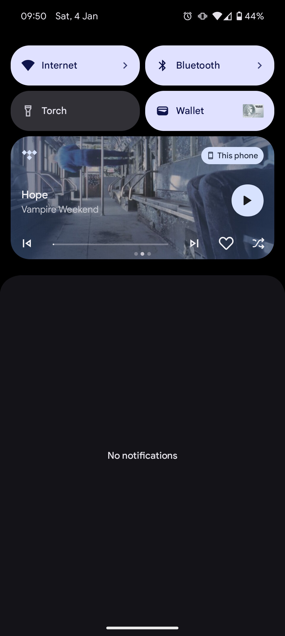

  3. The notification still shows in a playing state (the progress bar is in motion and the button is pausable)
  4. Compare this to the Tidal app, when playback finishes the progress bar is flat and the button is playable)
