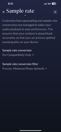

Go to Settings in the ARC app > Playback. Turn off Automatically Pick Best Quality. Then you can configure for wifi and Cellular
Thank you. I don’t see settings described as ‘Playback,’ am I missing something? This is what I see:
Thank you very much, S. Much appreciated.

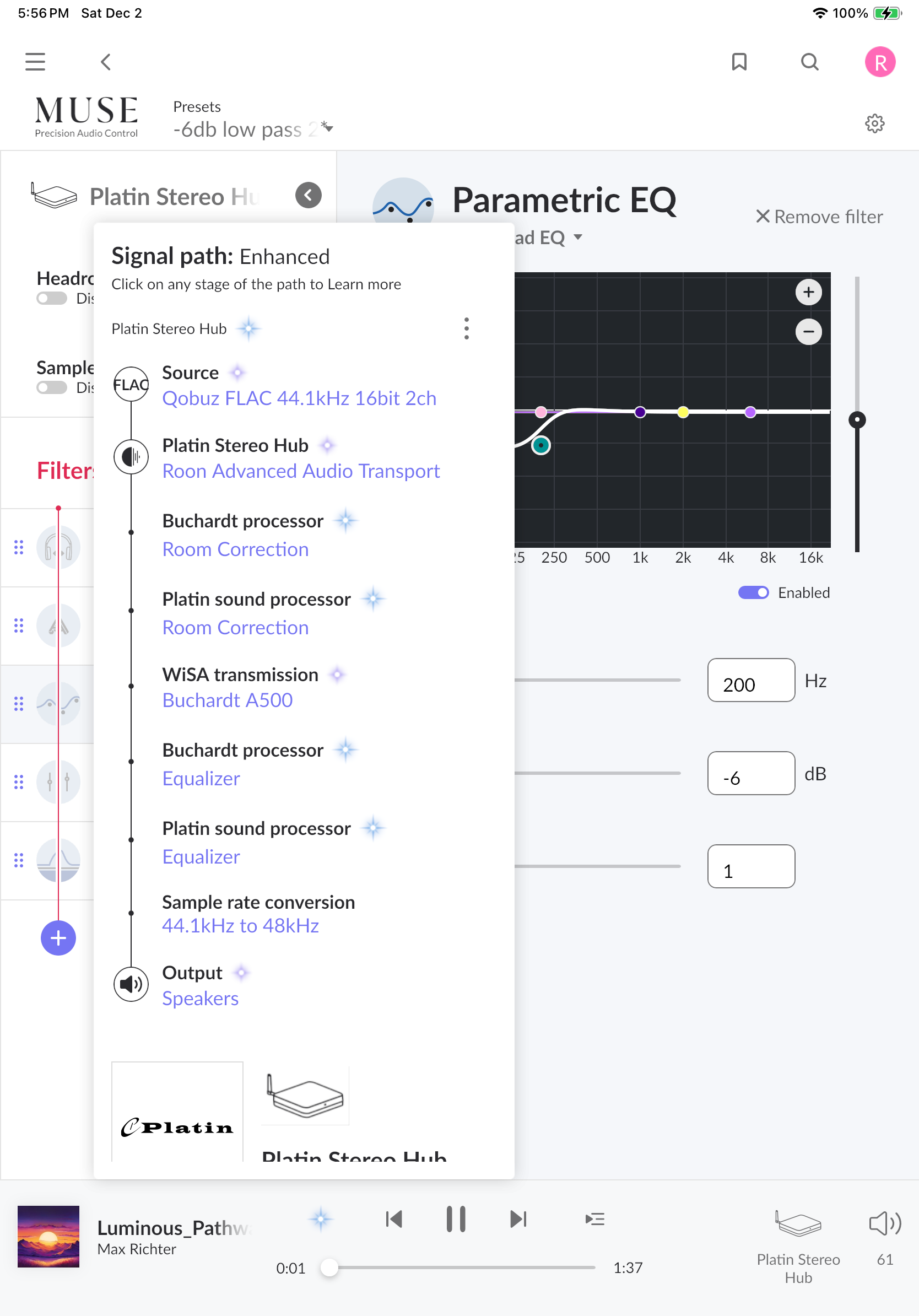

Follow up query: the signal path I’m seeing in Roon Remote has several stages listed that are not turned on in Muse, or in the Buchardt speaker software that I’m operating. (Listening with Buchardt A10 active speakers streaming through Platin Hub via Ipad Pro. I am using the Buchardt room correction feature only.) Can anyone advise as to whether this is normal or not, and if there is anything about these particular settings that should be optimized? Thanks
Roon is only responsible for the signal path up to the RAAT delivery to the Stereo Hub, green in the screenshot below. After that, Roon only reports what happens in the Burchardt, red in the screenshot:

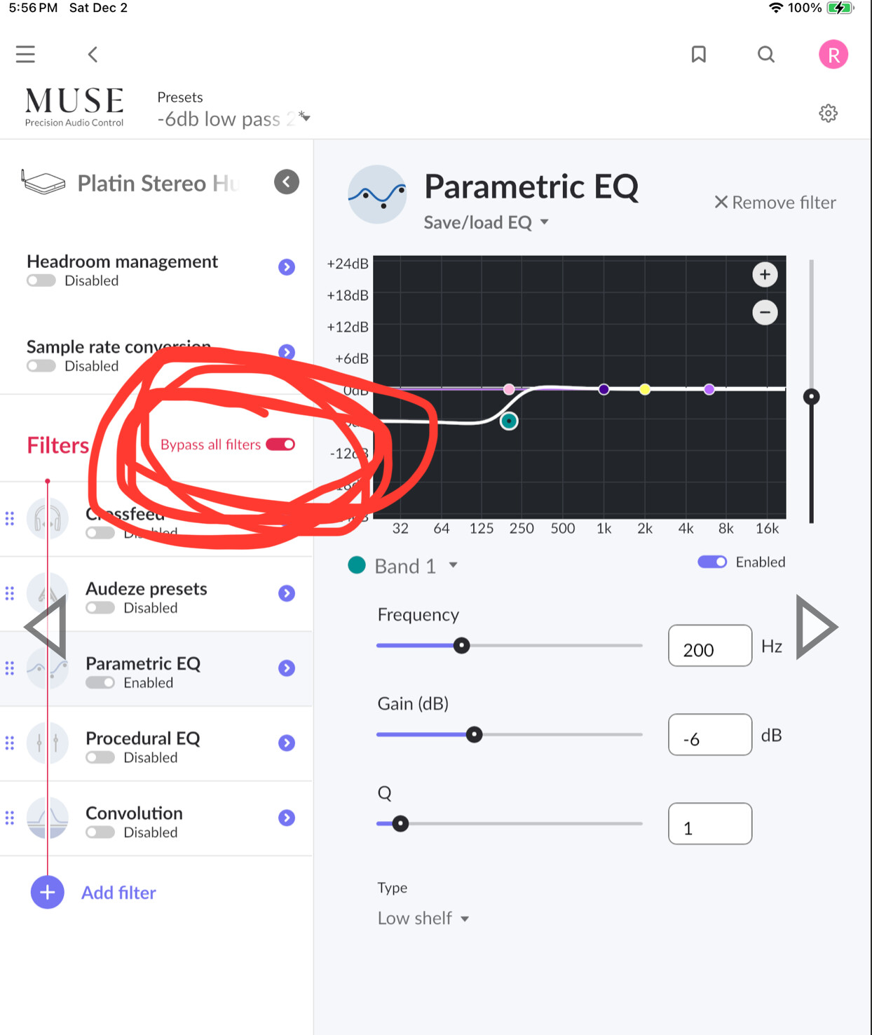

Here in Muse you enabled „bypass filters“, therefore these don’t appear in the signal path:
Yes, but if you look at the path next to the EQ settings in Roon the filters are turned off and yet there are still the points where the signal might be altered that are indicated. Is it normal that they should show when the filters are turned off? And should the sample rate be converting from 44.1 to 44Hz?
Yes it’s normal. The purpose is that you can configure filters and then bypass them all with one switch for comparison. You just bypass them, not remove them, and you wouldn’t want them to get removed just because you bypass them.
I don’t see a sample rate conversion from 44.1 to 44, just from 44.1 to 48. That happens post-RAAT in the Stereo Hub, so I don’t know
Thanks S. I understand now. Yes, you’re correct. It’s from 44.1 to 48, which I guess means that the Platin Hub is up sampling automatically, but would it be better if there wasn’t up sampling and is there a way to control that?
