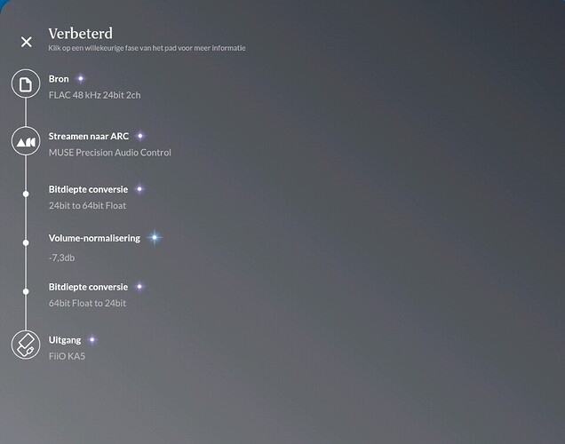

See attacbed jpg on any phone i own it’s lossless

It’s not losless just as indicated by Roon. It’s “Verbaterd” in english “High Quality” but not lossless. It is also indicated that bitdepth is converted to 64bit and back again to 24bit. Strange and completely unnecessary. This behaviour is only occuring on my tablet. On my phones Oneplus 9 Pro, Sony Xperia 5 MKII this does not occur. On these devices the stream is left unmodified by Roon Arc. There it’s handled the right way. It should be like this.
The stream is lossless which is defined by your source files/stream, there is additional processing (as you mention) so that stage is indicated by a different status (High Quality) & colour indicator, the stream is still lossless.

The behaviour is simply not consistent across Android devices. On Phones it goes right on my tablet not… one should be able to rely on the end result being the same in streaming to Android devices. This is simply not the case

In your first screenshot, the overall signal path quality is Enhanced and not Lossless because Volume Levelling is involved and it is enhancing your listening experience. For the same reason, to apply volume levelling, you have the bit depth conversion 24bit64bit Float present in the Signal Path. The default volume levelling setting is Auto but you can disable it via the MUSE screen in case you do not need it.
The second screenshot which you took while using your phone does not have volume levelling enabled and the Signal Path remains Lossless. That said, your device have different MUSE settings that is why the overall Signal Path quality is different.

Indeed but strange that my phone didn’t had this enabled and my tablet did… Both devices are left default on this setting.On the Tablet ARC is installed only 2 weeks ago. On the Phone somewhere in march this year.

Hi, @PixelPopper, it is correct, yes. High Quality stages are going to appear when the app is doing automatic upsampling or downsampling to match devices capabilities, for example. In this case, though, the overall quality is Enhanced since volume levelling is applied and it enhances listening experience.
@Bennard_van_Diermen, thank you for the reply. By any chance, did you change your volume levelling setting on your phone/tablet? I just wanted to clarify that my theory is the behaviour you are observing at the moment is happening due to the fact that you have differnt volume levelling settings on these devices. Could you please, check what do you see on MUSE screen → Volume Levelling?
