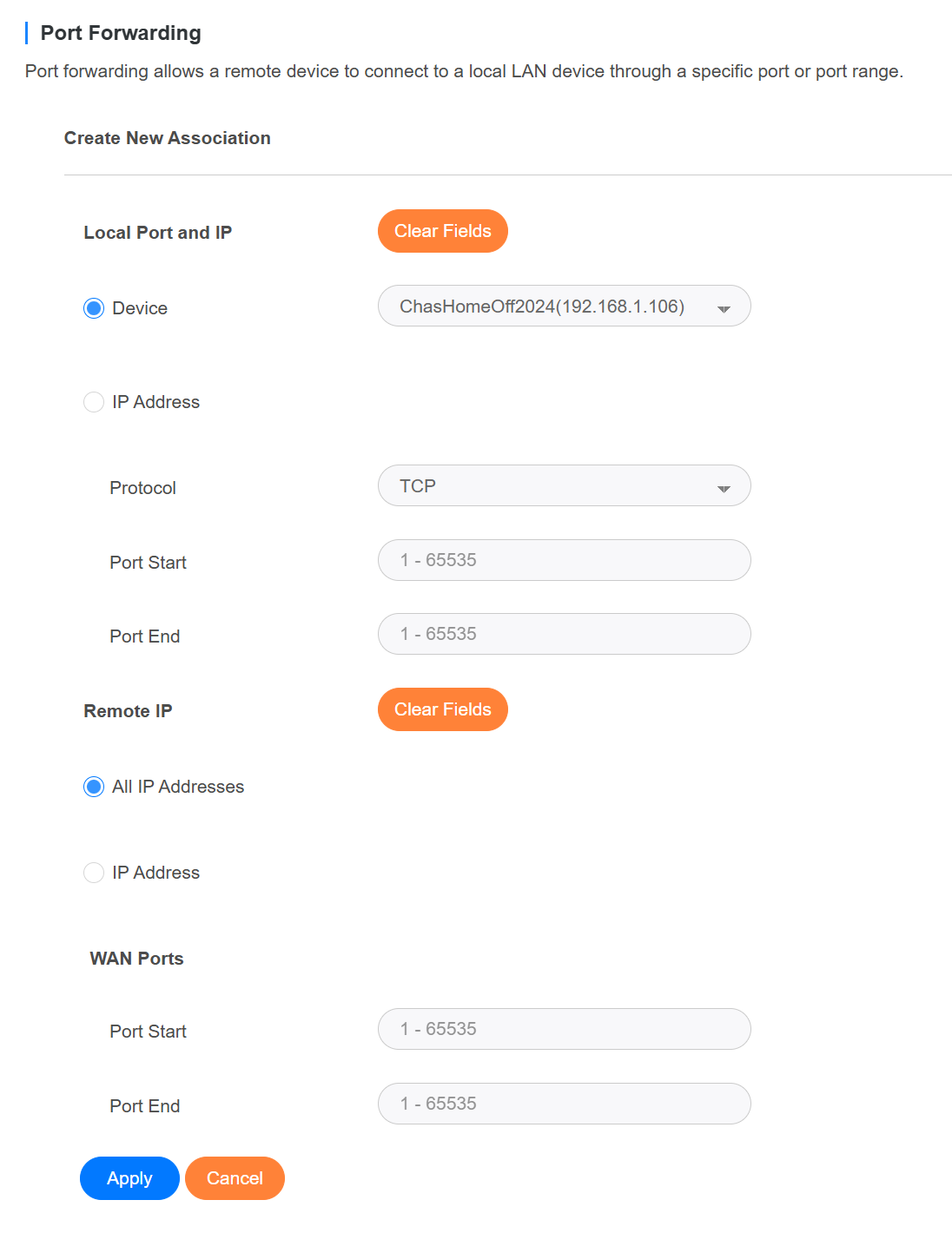

I continue to see "Not Ready" in settings for Roon ARC. I can access my router just fine. I can see that UPnP and UPnP Nat-t are both enabled. I am running Norton 360, but it looks like the firewall allows Roon. I have tried shutting off firewall on my Calix Gigaspire GS4227E and several other things. I freely confess I don't know what I'm doing here so I have attempted to always revert to default status after each attempt. What else do you need to know? Please be specific. I really understand very little of this.
ISP: Mahaska.org or MCG. What is my ISP says Google LLC.
Devices: Router is Calix GigaSpire GS4227E, Computer is Dell PC with a 13th Gen i9-13900 at 2GHz running Windows 11 Home version 23H2. 64 bit . Cell phone is Galaxy S22 Ultra model SM-s908U running android version 14.
Roon server is the desktop PC listed. It is hardwire connected to the router via Ethernet cable. Current connection speed is 600 mbps download and 800 mbps upload.
ARC is running on phone and PC? Not sure anymore.
Here is the diagnostic:
"ipv4_connectivity": {"status":"NetworkError","status_code":504,"error":"error: Error: ETIMEDOUT, response code: undefined, body: undefined connected? undefined"},
"external_ip": {"actual_external_ip":"167.aaa.bbb.ccc","actual_external_ipv6":"null","router_external_ip":"null"},
"natpmp_autoconfig": {"status":"NotFound"},
"upnp_autoconfig": {"server_ip":"192.168.1.1","found_upnp":true,"error":"s:ClientUPnPError501ActionFailed"}
