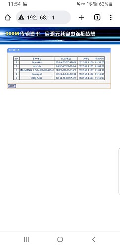

    The first router is by TPlink to enable Internet connection via PPPoE on 192.168.1.1/24, followed by an OpenWRT router(192.100.1.100)to work as an DHCP server on 192.168.100.1/24, on which band Synology is assigned 192.168.100.172 and Roon Core is installed in it.

“connectivity”: {“status”:“NetworkError”,“status_code”:502,“error”:“error: Error: connect ECONNREFUSED 89.jjj.kkk.lll:55000, response code: undefined, body: undefined”},
“external_ip”: {“actual_external_ip”:“89.jjj.kkk.lll”,“actual_external_ipv6”:“null”,“router_external_ip”:“192.168.1.100”},
“status”: “status”: MultipleNatFound
“upnp_autoconfig”: {“server_ip”:“192.168.100.1”,“found_upnp”:true}
Let me copy Roon’s standard response to the MultipleNatFound error. Given your two routers, it’s probably the first issue
The diagnostics you’ve provided suggest there is a redundant layer of network address translation preventing port forwarding.
This can either be at the local-network level (commonly as a result of two routers), or at the level of your service provider (in the form of carrier-grade NAT).
If your setup involves an ISP-provided gateway (modem/router combination) and your own third-party router:
  • In the web administration interface of the ISP-provided gateway (modem/router combination), enable Bridge Mode or equivalent, where the ISP-provided gateway does not have DHCP routing enabled.
  • Alternatively, if you have already created a manual port forwarding rule in your 3rd party router, you can add an additional rule to forward the port through the ISP/second router.
