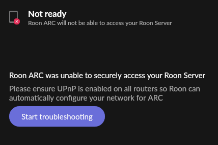

· Roon ARC suddenly unable to access your Roon Server but I did ensure that UPnP is enabled.
· No VPN on, I use an Amplifi Alien, Spectrum internet, I'm hardwired to another Alien as a mesh point and it has been working for months without issue. Randomly last night it just stopped working. I do have UPnP enabled, even tried setting up a port forward rule for Roon, but that doesn't work.
I also tried uninstalling and reinstalling the Roon program on my Windows PC running Windows 11. That did not solve the problem either.
I had been using it all day yesterday without issue, I stopped briefly before going to bed, and was going to put on some music again only for the server to suddenly be inaccessible.
