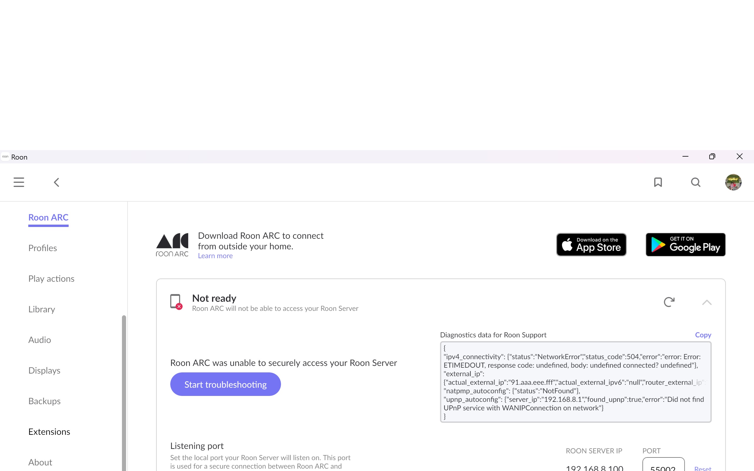

Currently/Presently (Second Setup). I'm using HUAWEI 5G CPE, Model: H112-372 as a source of internet. I disabled the wireless/wifi of this router and I use utp cable to connect from LAN1 going to the LAN1 of the eLife Connect C1AA (configured as switch). I directly connect my Intel NUC roon server to the Router eLife Connect C1AA through UTP or Ethernet Cable. And all my roon remote devices was also connected on the same router using wired/wireless connection. It's working well using roon remote app and ARC on the same network. But if I'm out of that network I'm using other network or mobile data I cannot access roon server.
I followed all the steps provided in START TROUBLESHOOTING but still didn’t work.

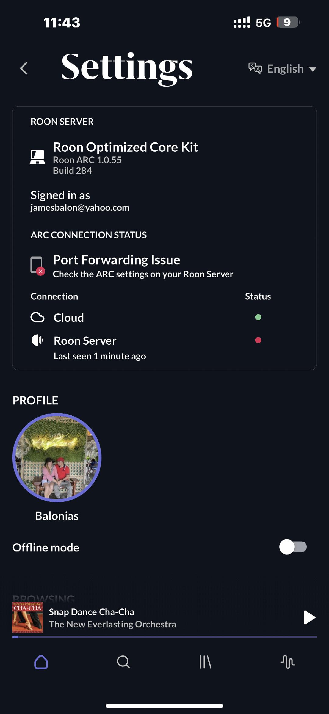

But if I’m out of that network I’m using other network or mobile data I cannot access roon server.
Meaning to say, If my phone (roon remote) is not connected in the same home wifi network, the roon ARC cannot access roon server.
the other network.
Meaning to say, if i will switch off my wifi connection to my home network and I’m using mobile data OR I will connect the wifi of my neighbors. I cannot access my roon server using roon ARC. Please look at my attached screenshots.
@Jamesbal, thank you. Who is your mobile provider? Most mobile service providers use CG-NAT to share one IPv4 address to multiple subscribers, and CG-NAT does not work with Roon ARC currently.
If you continue to have problems, you may want to try Tailscale, a VPN service that Roon recommends in situations such as yours. I have a different issue with ARC but Tailscale solved my problem and ARC works flawlessly now.
