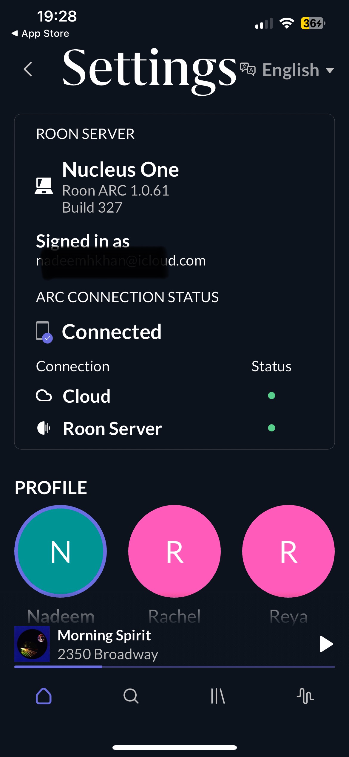

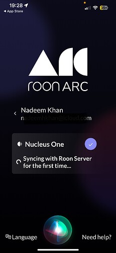

Roon ARC unable to connect due to Roon Server status not connected (ref#8FABX6)
Arc Settings page says Roon Server status not connected, tried port forwarding and Tailscale
ISP Community Fibre London UK (1Gps), Linksys SPNMXC56 router, iPhone 13 on Three network, tried 4G & 5G with decent internet connection

As your latest screenshot still shows „Ready“, did you disable the port forwarding in Roon again when setting up Tailscale? I wonder if somehow it might interfere. The guide says to do this in step #3:
Yes thanks, I tried Tailscale with and without port forwarding disabled. The only time Tailscale did briefly work was with Roon saying port forwarding was working (i.e. as per screenshot, but without actually enabling it inside the router).
Meaning that you disabled the port forwarding in Roon → Settings → ARC by entering “0” in the port value?
Yes, like this:

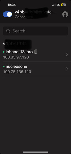

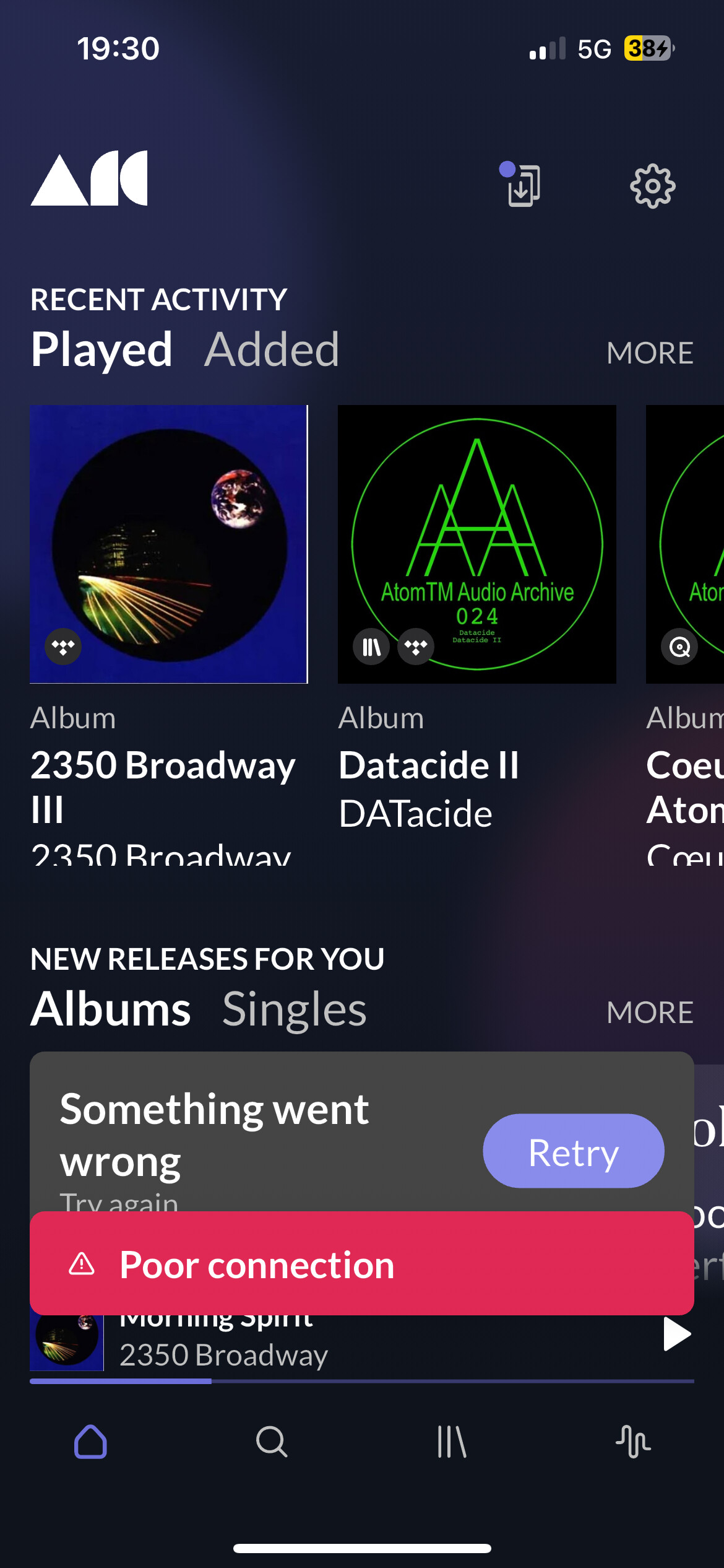

Hi @connor I’ve done as you suggest, deleted Arc from phone, checked I’m signed into Tailscale on Roon web admin page, checked in Tailscale on phone that both phone and N1 are logged in to same TS network (screen shot attached) reinstalled Arc. As before, it works if I’m on the same WiFi network but not over cellular.

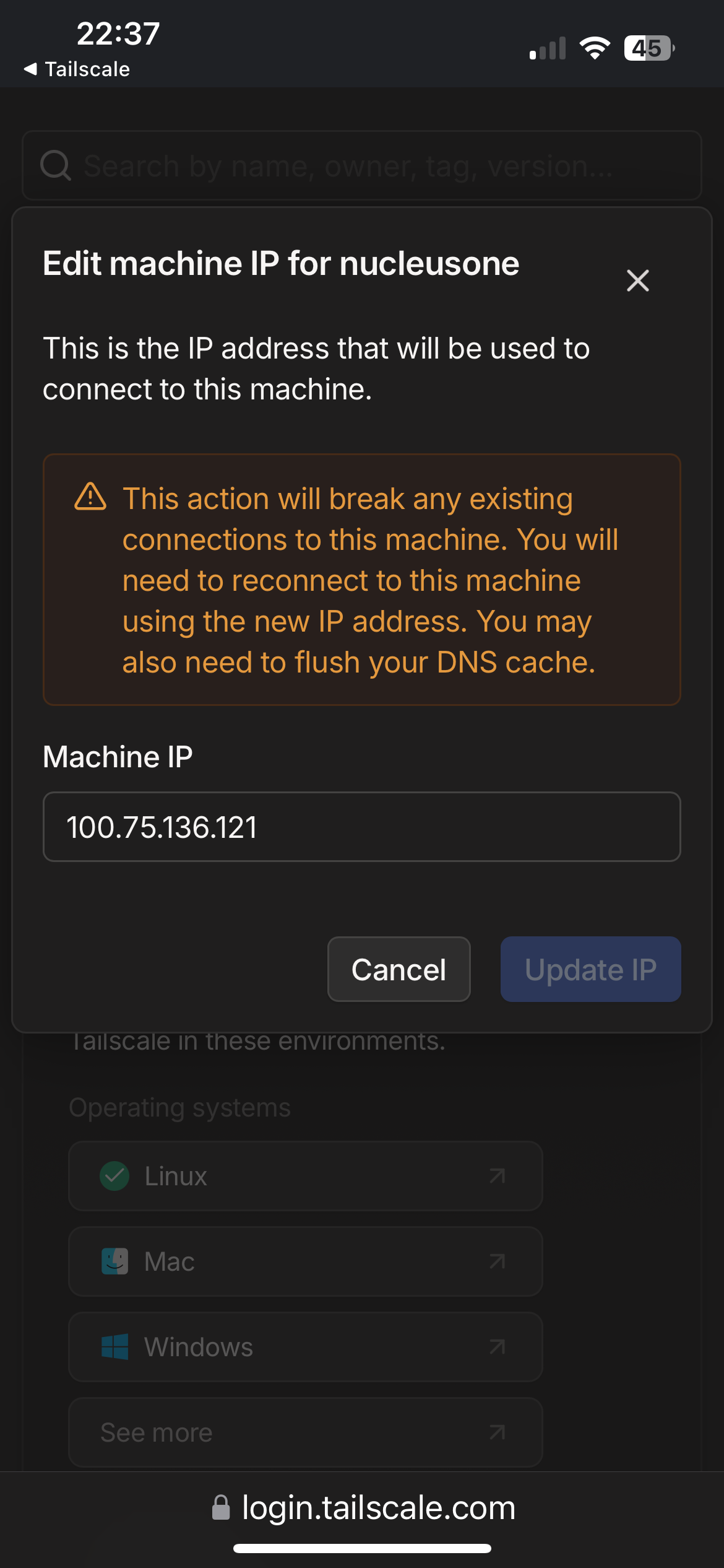

These two look like different subnets, if they were on the same Tailscale net it should theoretically be the same subnet. Have you configured your Exit Node properly in Tailscale?
Hi @noris - please tell me where to find that setting. I’ve only downloaded Tailscale on my phone, and I can’t see a setting for subnet/exit nodes. Do I need to also download it elsewhere? Please let me know exactly what I need to do/change. Thanks
Hi @Nadeem_Khan,

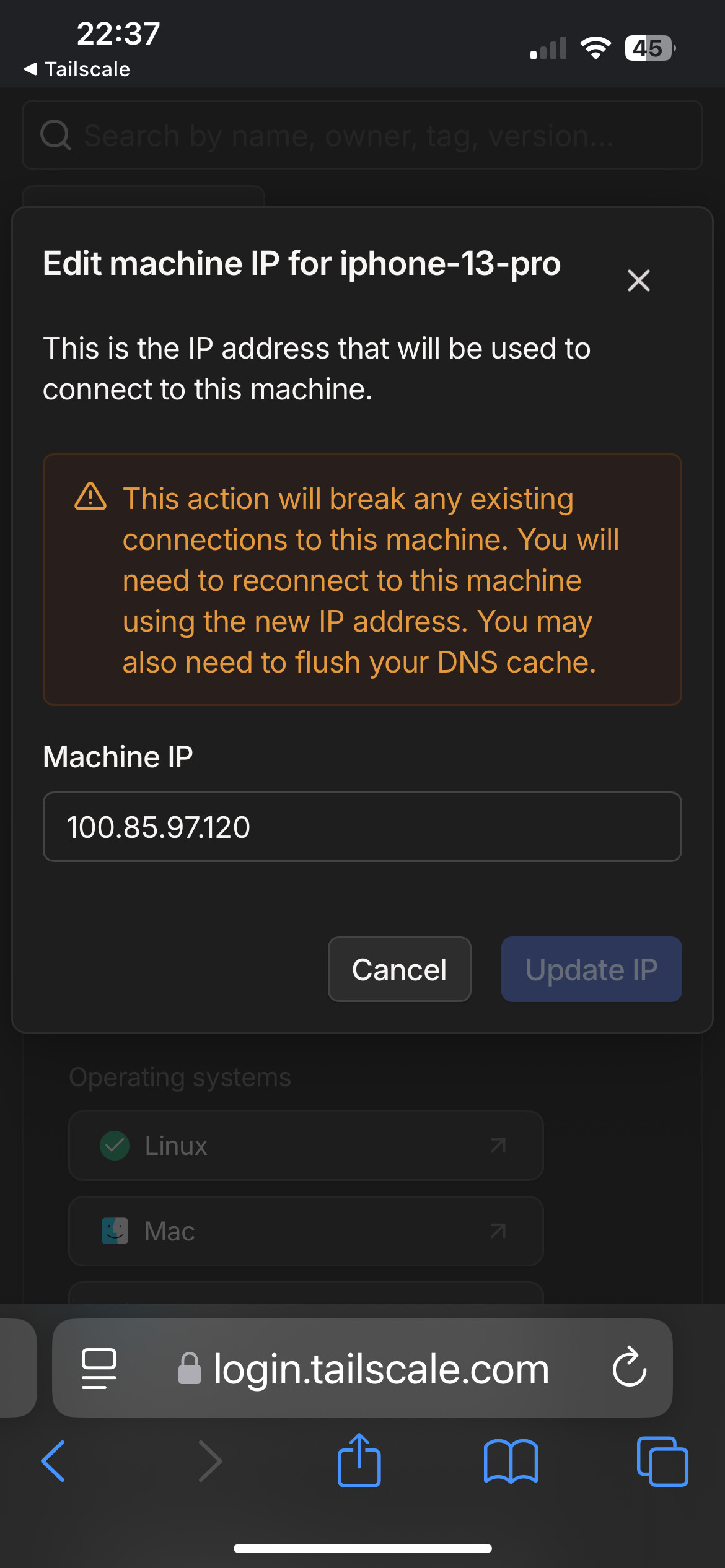

You’ll need to enter the Tailscale accounts Admin Console. In the app, it’s usually under Settings → Accounts → Admin Console.

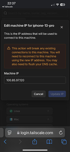

Navigate to the Machines tab. You should see the same devices listed above, your iPhone and Nucleus, along with their Tailscale IP addresses. Use the three-dots or edit options on one of two devices to manually edit the IPv4 address. Type in an IPv4 address that differs by only a few digits after the final period (host ID).
Please let us know if this helps.

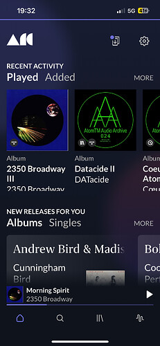

Thanks @connor this has worked. One address ended 120, the other 113 which I changed to 121. Tbh this is all another language to me but I’m amazed it worked- many thanks and if it stays stable over the next few days I’ll mark this as the solution.
