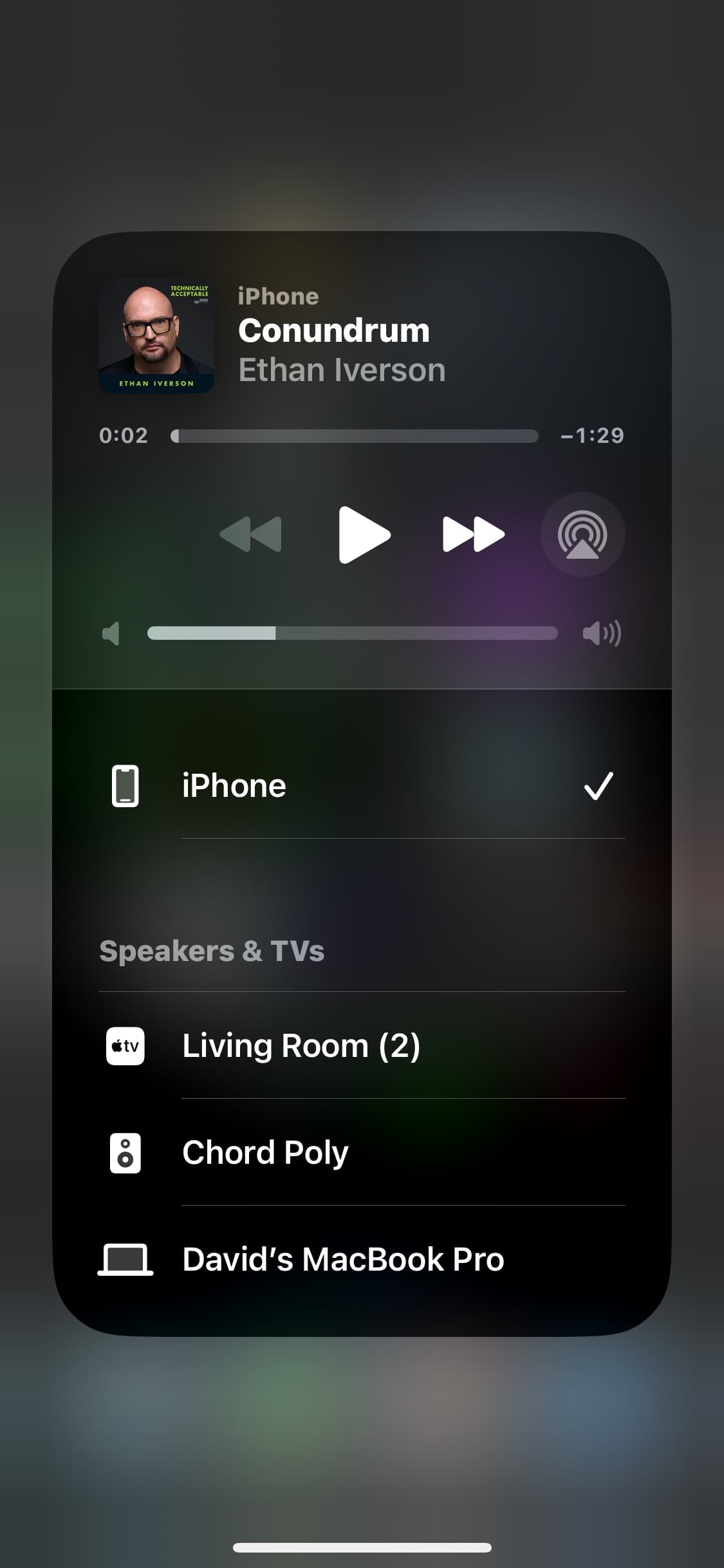

As I understand it, the only way for the Chord Poly to reach Roon ARC is via Apple AirPlay in order to achieve music listening at high fidelity (and not using Bluetooth as that will degrade the sound). I also desire to connect the Poly to my iPhone using hybrid hotspot mode as that allows me to have access to the web while on my phone. That setup is described here.
My setup process for Roon ARC is:
  1. Launch Gofigure app so the iPhone can connect to the Poly
  2. Select my Chord Poly as the WiFi source. Note, those steps are also required to play music stored on my SD card
  3. Launch AirPlay and select the Poly as the source
  4. Launch Roon ARC and begin playing music
With those steps completed, I can listen to Roon ARC on the Mojo2/Poly. Typical dropouts occur within minutes, sometimes not occurring for up to 15 minutes, making Roon ARC unlistenable for all practical purposes.
