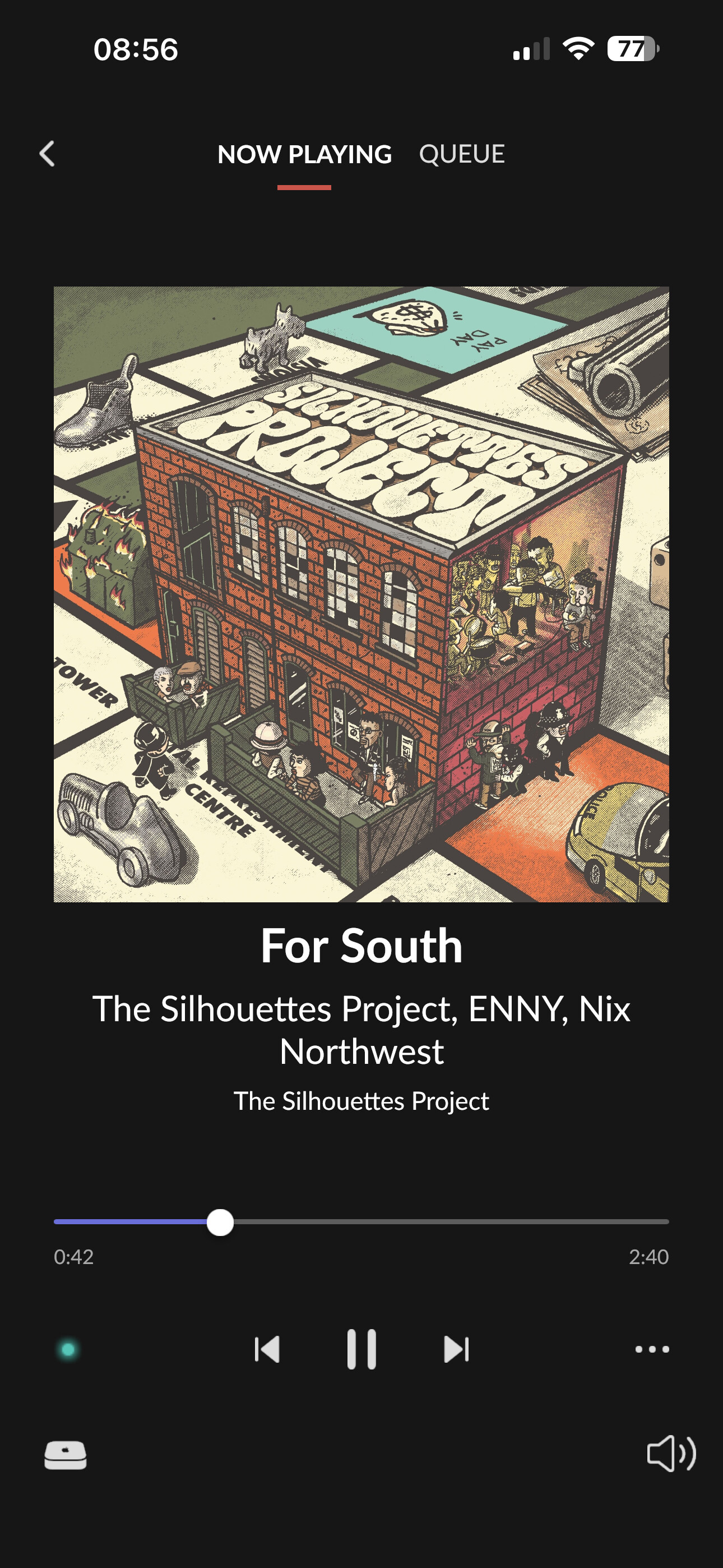

I have just toggled that on and it’s was out of sync for the first 20 secs. Then the panning started to happen. Seemed to fix itself then started again.
08.53am and 08.56 (31.10.24) for time stamps and see screenshots for track info.
I thought it may have something to do with HDMI arc so I switched it off and the timing was out at the start again and then panning ensued at 09.00am - 09.01am
Hope this helps :crossed_fingers::pray:
