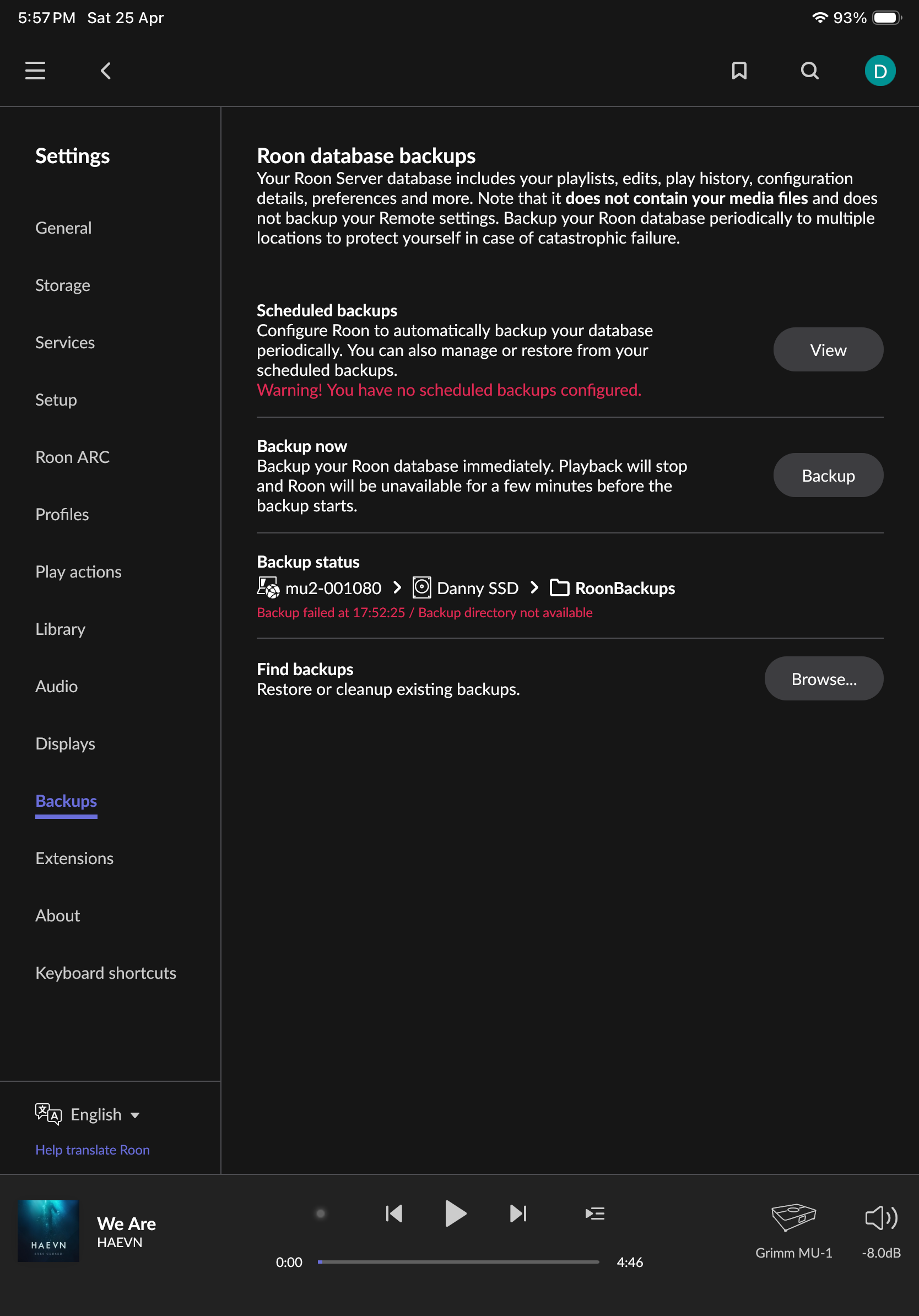

· I was using a roon neuclus but have now switched to a Grimm MU2. My Roon backup was done on the neuclus with an external USB drive, now when I plug in the USB drive to the MU2, the Roon backups fails and says that the backup directory is not available.

Thanks for all the help guys. What do Grimm owners do to backup if I don’t use a NAS. Can I back up into the internal drive of the Grimm?
