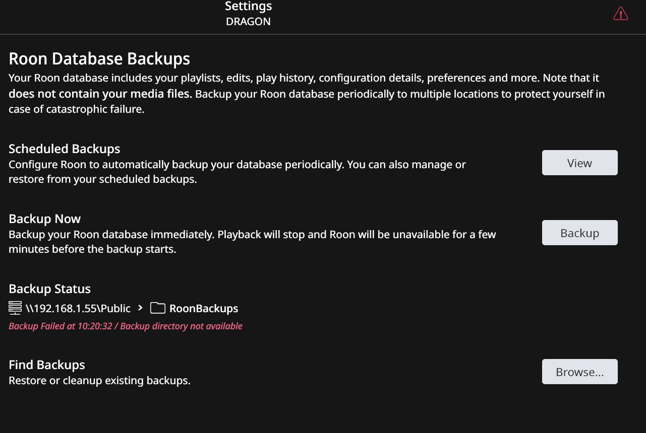

It looks like the backups are still not working. Sigh. Here is the backup settings
Thanks,
Goran
Hi @G_Man,
Thanks for the screenshot. I’m not seeing your Core communicating with our diagnostics servers any longer, can you please use these instructions to upload a new log set via Dropbox / Google Drive / Send.firefox.com?
