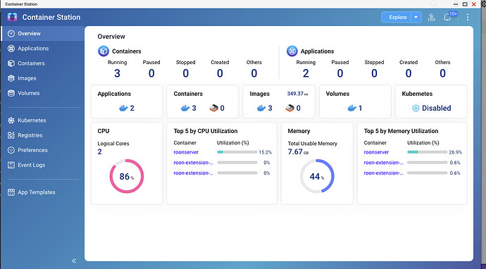

Similar behavior just occurred. Was out all day, came back and started Roon. Lag with a Qobuz album and managed to capture the following:

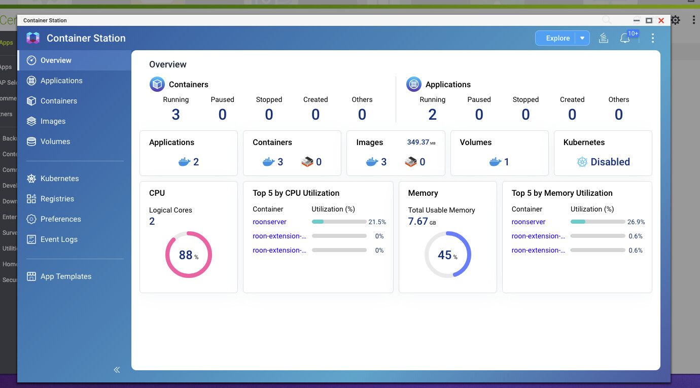

Then switched to a local file. About a 3-4 second delay and captured the following:

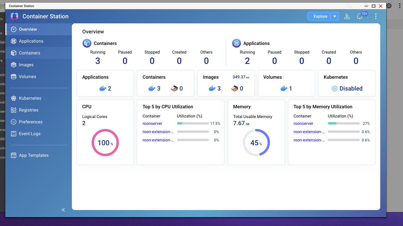

CPU running between 75% and 100% and music stopping. Just now stopped, skipped a song and started playing the third sone on Their Satanic Majesty’s Request.
Time stamp from about 8:10 pm to 8:19 pm US EDT.

Thank you for the screenshot. This is very revealing — the Container Station Top 5 shows only Roon at 21.5% and extensions at 0%, yet the overall CPU is at 88%. This means the remaining ~65% is being consumed by the QNAP OS itself or its native services, completely outside of Docker.

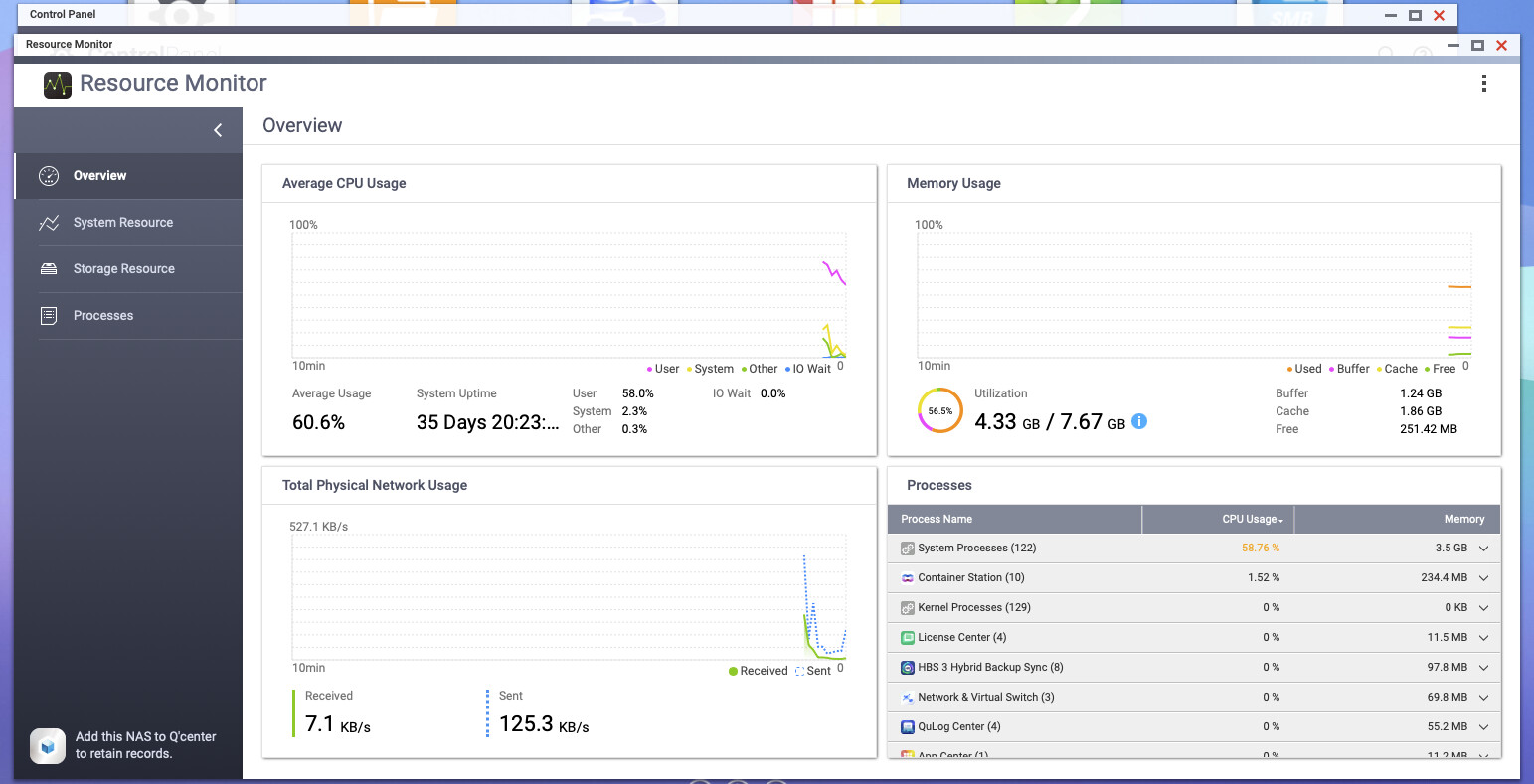

Could you open the QNAP Resource Monitor (not Container Station — it’s a separate app in the QTS app menu) and check the Processes tab during one of these high-CPU periods? That will show us exactly which QNAP service or background task is responsible. Common culprits on QNAP include antivirus scans, Multimedia Console transcoding, thumbnail generation, or scheduled backup jobs. Once we identify the process, we can look at disabling or rescheduling it.
One additional thing worth keeping in mind: the QNAP TS-251 uses an Intel Celeron processor — a low-power chip designed for light NAS workloads. Under sustained load it throttles its clock speed to manage heat, which means that even Roon’s modest 21% share of a throttled CPU represents less real processing power than it might appear. Identifying and resolving whatever is driving that background load will help Roon get the most out of what the hardware can offer.

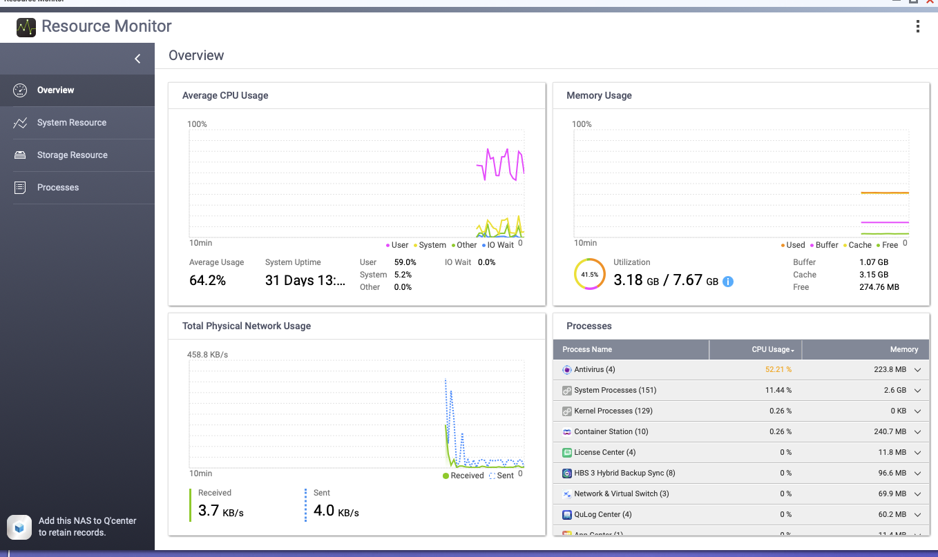

It looks like antivirus scans may be an issue. Schedule was weekly starting at 1 pm on Mondays. Was still running when I took the shot below.
I’ve deleted the schedule and have added a new one for Thursdays at 6 am. Not sure why it was still running from Monday.
This is only the Music server. No other files except Roon running on the attached USB SDD. Have a 2nd USB HD attached that simply backups the QNAP so I have a back up of my music files.

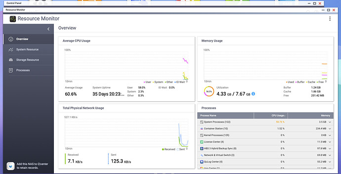

Just happened now. June 7, around 4:30 pm US EDT. Playing A Rift in Decorum.

Your screenshot corroborates this: CPU averaging 60% with “System Processes” at 58%, Roon’s work on a NAS appliance shows up partly as system/kernel CPU, and the Celeron simply runs out of headroom.

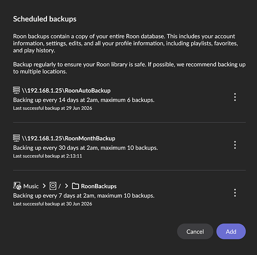

How can I confirm that my backups are saved and not corrupt? I have two backups, both located on another NAS drive, and a third on the same NAS as the Roon Server (which runs on an SDD attached to the “Music” NAS). See image below:
Does the note about “Last successful backup…” confirm that the backup is not corrupt?
If so, I’ll proceed with moving Roon to the Dell.
Thx.
