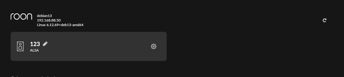

I attempted to reproduce this on a Debian 13 test setup on my end, and RoonBridge initialized correctly, but this may depend on the specific package snapshot in “Trixie” currently installed.
I wanted to take a deeper look at your logs to confirm the ABI mismatch, but I hit a snag: the timestamp you shared seems to be 09/03. Since we are currently in February, the system interprets this as March 9th, which hasn’t happened yet.
