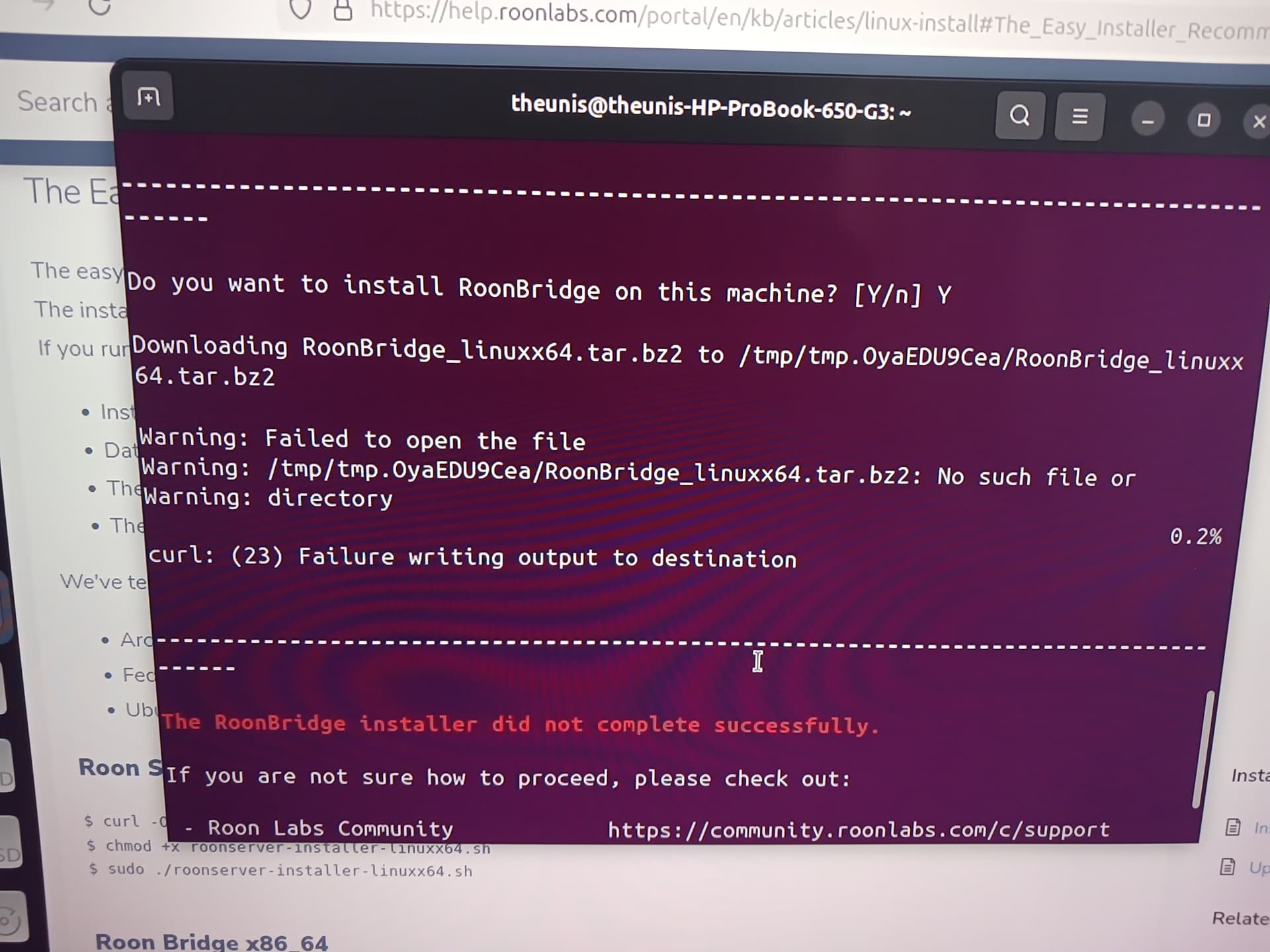

Good day, when I run the
http://download.roonlabs.com/builds/roonbridge-installer-linuxx64.sh manually on browser then a bash text file - script can be seen. All the lines in file.
But when I run the script on terminal
curl -O http://download.roonlabs.com/builds/roonbridge-installer-linuxx64.sh
with curl -O
I get the fillowing message on screen
Downloading Roonbridge_linuxx64.tar.bz2 to /tmp/tmp/OyaEDU9Cea/Roonbridge_linuxx64.tar.bz2
Warning: Fauled to open the file.
Warning: /tmp/tmp/OyaEDU9Cea/Roonbridge_linuxx64.tar.bz2: No such file or directory.
Curl: (23) Failure writing output to destination.
The Roon bridge installer did not complete successfully.
