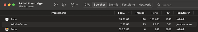

Right after startup memory usage of Roon on MacOS is below 1GB. After some days memory usage goes up to 16GB. See screenshot:
A restart of Roon Client solves the issue. After some days memory usage is again 16GB

In the meantime I have shifted the Roon Server to an Ubuntu environment. The issue is still the same. Please see the screenshot.

  • The actual problem does not occur on the server. It’s on my Mac Mini M2 pro. The Roon client is currently using 12GB of memory again. Roon Client on MacOS is supported, isn’t it? So why don’t have closer look to that?
