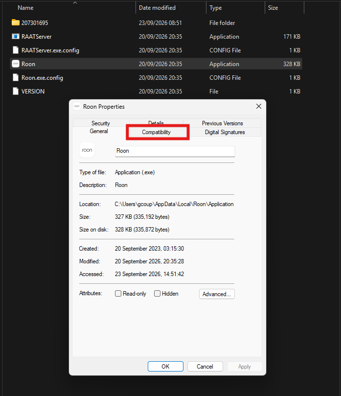

Check that you haven’t used Windows Compatibility settings in the past. See this thread here:
I right click on the Roon shortcut and choose Properties. I then try to choose Compatibility but I get a message saying The folder specified in the Start box is not valid.
You don’t click on the Roon Shortcut, but you click on the Roon.exe application itself, as shown in my screenshot in that thread..

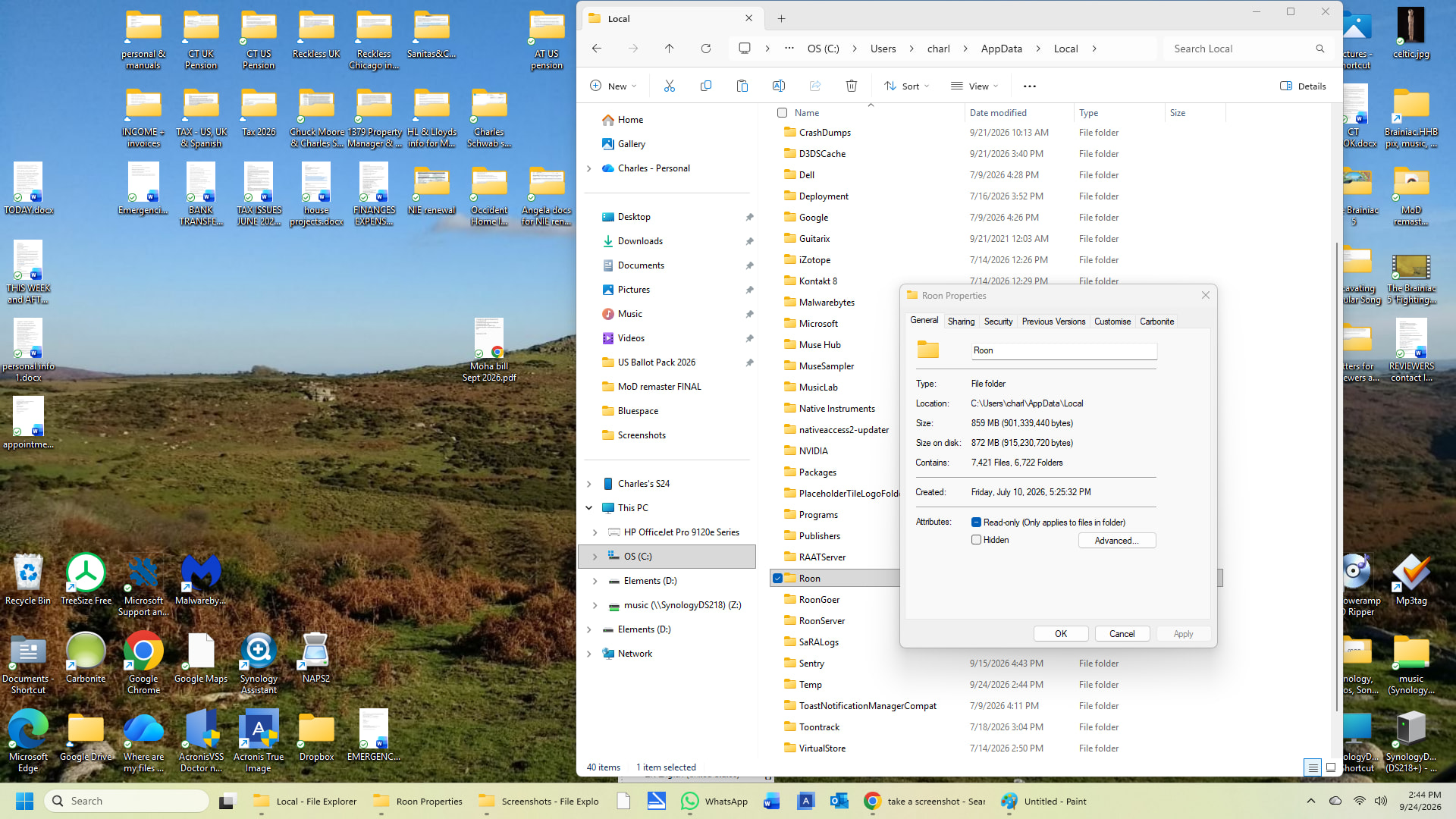

I went to Roon.exe as you suggested The Roon.exe program will usually be found in C:\Users\<username>\AppData\Local\Roon\Application. I then clicked on Properties, but there is no Compatibility tab there.
Well that’s very odd - it’s certainly there for me. What exactly is your version/build of Windows 11?

Can you post a screenshot of your Properties screen for Roon.exe? I’m curious to see what you are seeing. Thanks.
Posting screenshots on Community
Just a thought - are you just looking at the Properties of these folders? That’s not what you do - you will only see the Compatibility tab when you look at the Properties of the executables, e.g. Roon.exe in C:\Users\<username>\AppData\Local\Roon\Application.
I’m saying this because you mentioned you looked at the Properties of RoonGoer - and this folder does not actually have an executable (an *.exe file) within it.
Yes, you’re right. I have followed that path and it now shows the Compatibility tab.
It says “run this program in compatibility mode for Windows 8”. That box was ticked. I’ve now unticked it. Stlil getting the popups. I’ll now restart the PC and see if that helps.
